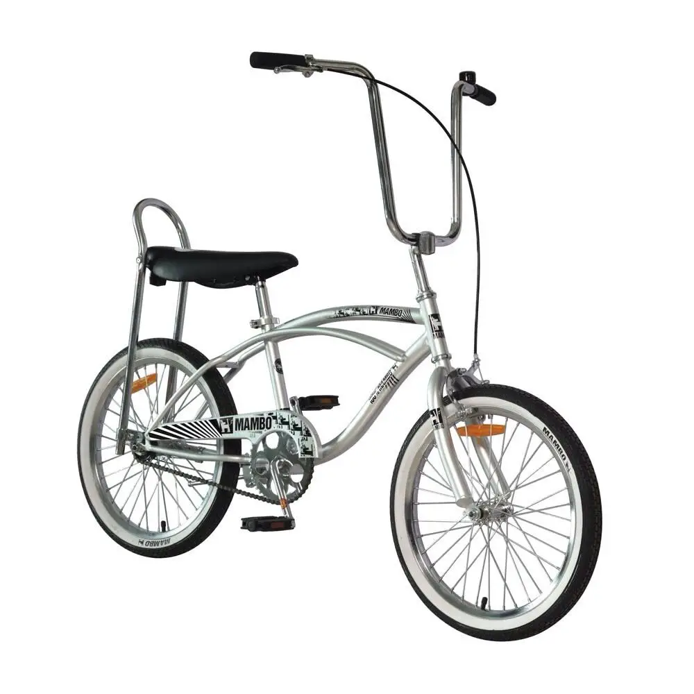

So I picked up two of these tonight rather cheap and I'm planning on mounting an A80 kit to it. Could it fit in the main body or better under or outside the sissy bar?

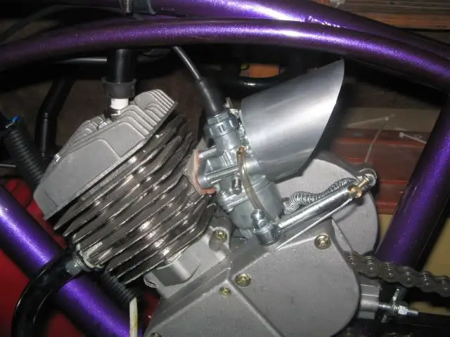

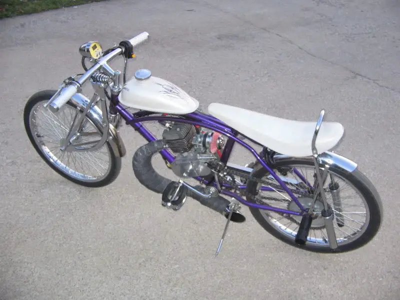

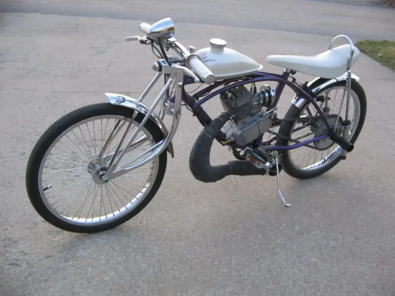

here's my 20" bike, but if you notice, mine does not have an intake manifold. My carb is mounted right to the cylinder, which gives me lots of clearance.
My engine is a 49 c.c. china 2 stroke, and i'm not sure if they still make them this way (without the intake manifold). Mine has a totally different style carb on it than the normal n.t. carb, because the carb is mounted to 2 studs that screw into the cylinder.

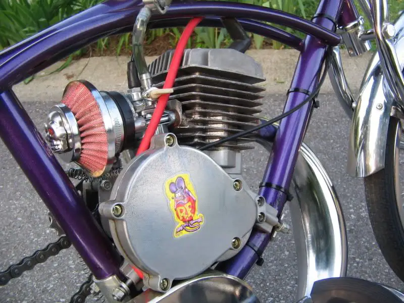

here's a closeup of the carb on my engine...no intake tube, no clearance issues.
