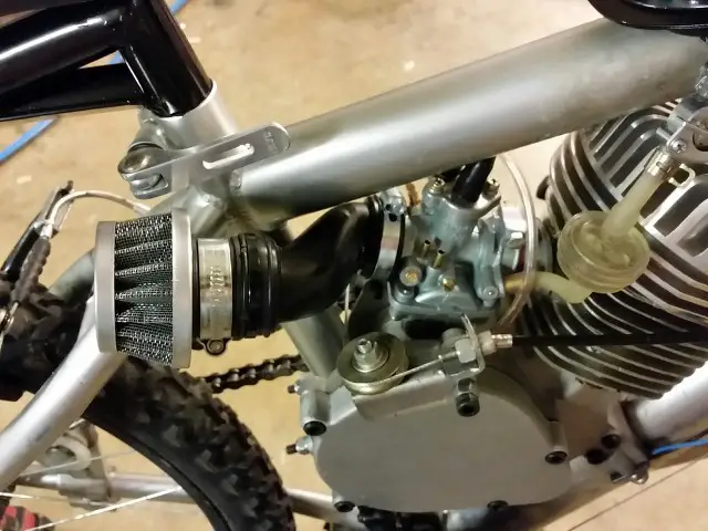

Here's a quick shot of my fuel filter, this is the Briggs inline filter that costs around $3 if I remember right...

It's a stock intake pipe for a Yamaha PW80, I got it because that's what type of carb I'm running. My carb is a PW80 carb but I found out that it's the same carb as the CNS carb so it'll bolt right onto a CNS carb as well
