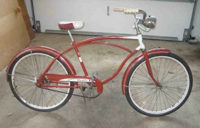

I just finished my first motorbike and have taken the 1st ride, what a blast! I can't wait to spend some time on this thing. I purchased the kit off eBay and just worked on it here and there when I had a few spare minutes.
I started with a 1950's Columbia Rambler that I picked up for $60 at the local flea market. Had I known the difficulties involved in mounting a motor to this type of frame with the curved downtube I may have selected another bike but I'm happy with the results and it seems to be working well so far. I had to extend the rear motor mount which I did by picking up some threaded rod and then figuring out a way to shim the clamp out away from the engine case while still keeping everything rigid.
I picked the seat up at the flea market as well which gives it a real nice vintage look. My plan is to keep making improvements and letting the bike evolve. I think the first change will be a spring loaded chain tensioner and maybe a hub adapter to mount the rear sprocket. Other plans included changing the fuel line over to copper tubing, fabricating a gas tank and adding a front drum brake hub.
Take a look at the pics and let me know what you think! I'm already starting to think about what my next project will be!
