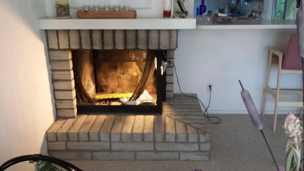

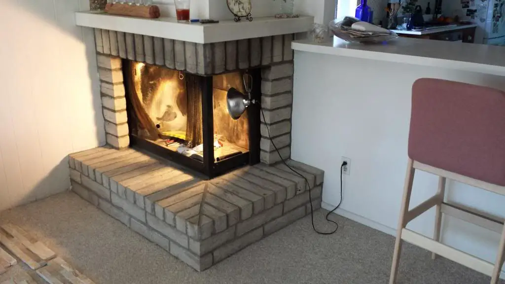

That's cool NKat......I just converted this wood burning fireplace I built 30 years ago at my parents home......
from this

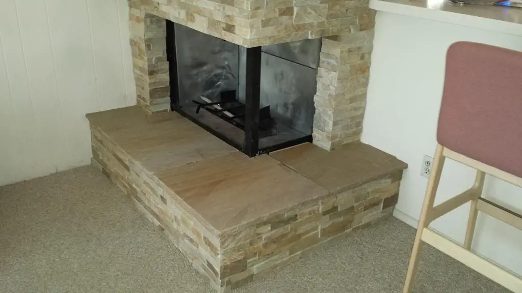

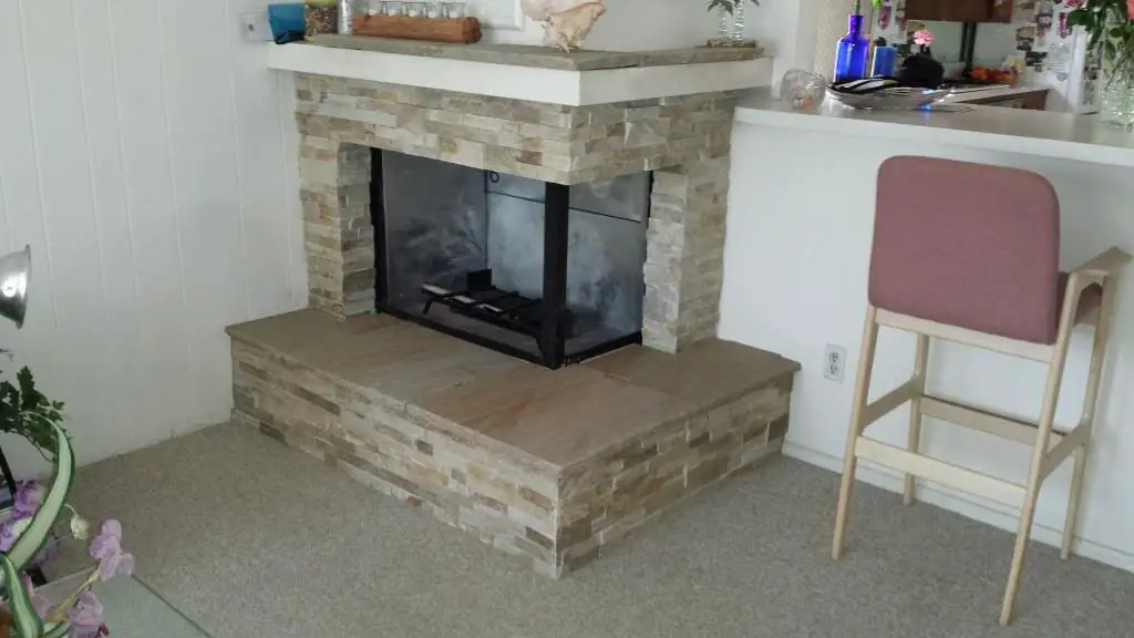

into this natural gas burning with a ledger stone facelift fireplace
Almost finished, just have to finish the stone capping on the mantle, and finish grout and install the gas logs and valve.
Which look do you like better, the original slump block or the ledger stone with sandstone hearth ?
