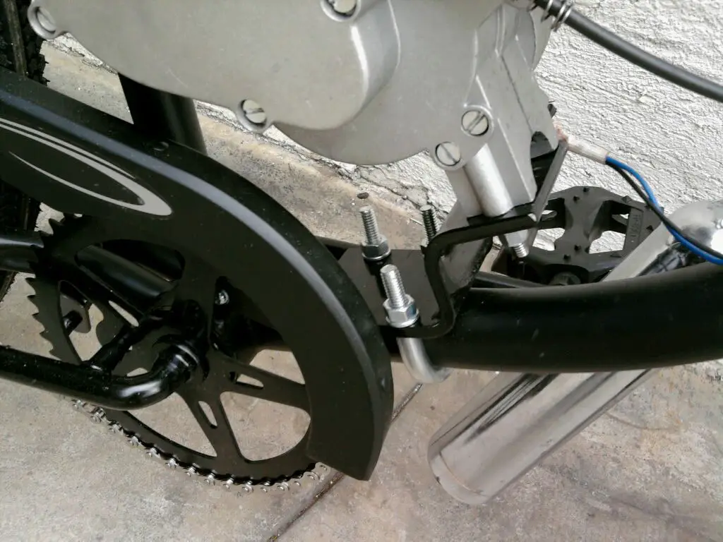

This is a good solid way of doing it... I use 1/4" steel & 'U' bolts for the front, & if the rear mount is a little too big for the frame?, I cut a shim for it from some electrical conduit.

Hang in there, peppers. Keep reading and looking at what others have done then take some time, wonder around Ace hardware and see what you can find. Innovation is the fun in this hobby. If everything could be bolted together..where's the challenge in that?
Just keep in mind this important fact; The engine must be mounted solid to the frame. The more rigid the mount, the better off you'll be. Keep us posted on what you come up with.
Take a close look at the mount pictured by Venice Motorbikes. Very simple and easily duplicated. No special tools needed, no welding and the materials can be had from any hardware source.
