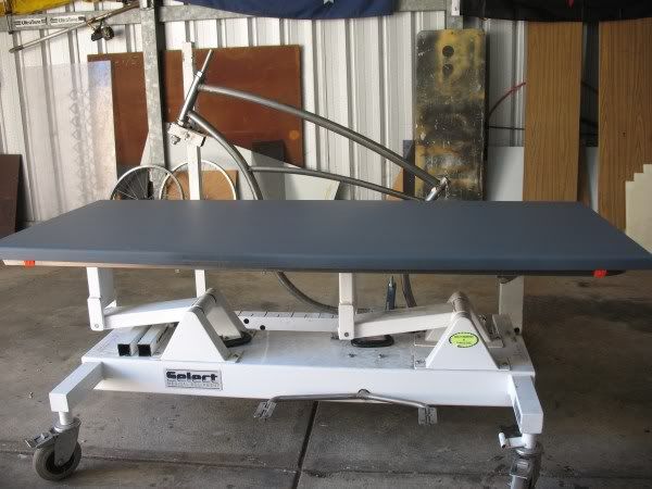

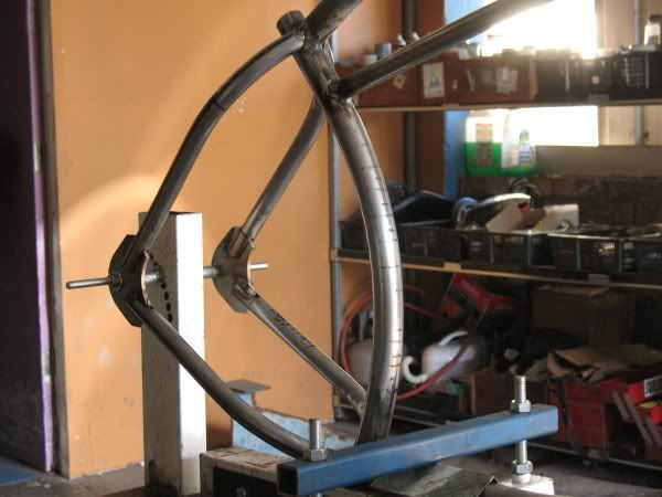

Not having a certain"member from Costa Rica's skills" to build frames accurately without a jig, i decided another frame jig was
needed, this time however a i wanted a re-usable jig for future builds-->

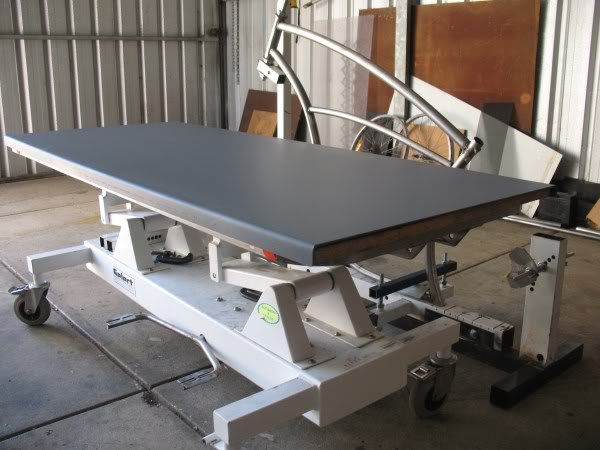

I used a couple of pieces of exercise equipment i found during kerbside rubbish collection
The addition of a new hydraulic height adjustable bench in my workshop has been a god send makes things so
much easier for me, the jig sits upon it.

Currently its set for this new frame, but could easily be altered for next build. I shall keep it stored away between builds.
One issue i have had with the last 2 frame builds is sourcing a 1 1/8 I.D head tube, on both occasions Matt.P has come to the rescue
donating first a OCC Chopper frame and now a West Coast Chopper frame, the headset was cut and cleaned
HUGE props to Matt, thanks again mate :) -->
I started bending tubes couple of days ago, taking it slow and steady, the tubing being used
is ~31 OD with a 1.6mm wall thickness for the front of the frame, chain stays will us ~21in 1.6mm wall thickness

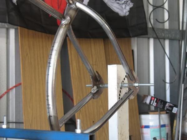

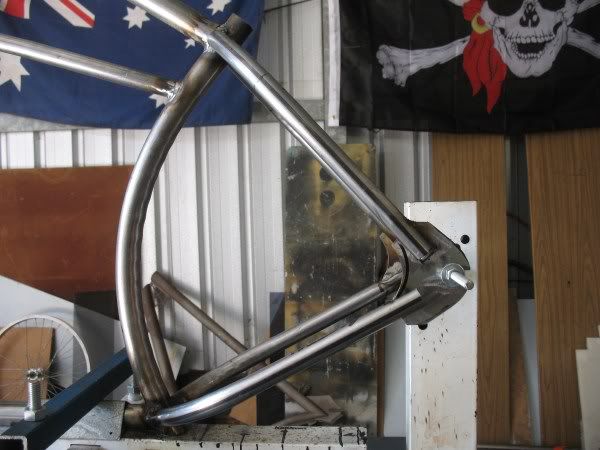

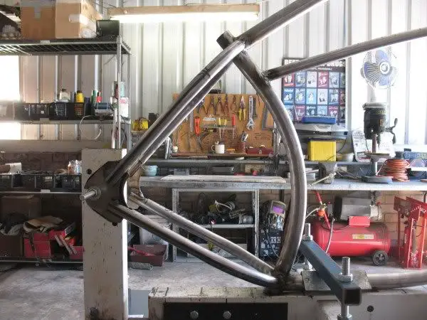

After making a mess of a couple of pieces i finally got the 'lines' i was looking for
in this frame, i roughly cut the tubing to length before I laid the frame out on the
concrete for a better look-->
Happy with the bends i then went about mounting the frame into the jig
notching the ends of the tubing and tacking it together-->
All the tubes lined up beautifully, they are very 'sturdy' tacs :D this combined with the jig
holding the frame in position for full welding will see the frame stay in this exact shape :) FYI: Frame has ~30 degree of rake for the curious amongst you ;-) ...

So...I positioned some scrap tubing on the rear to get an idea how the rear will come together-->
Hopefully next update will see pretty much complete frame ready for full welding...

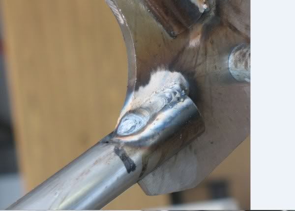

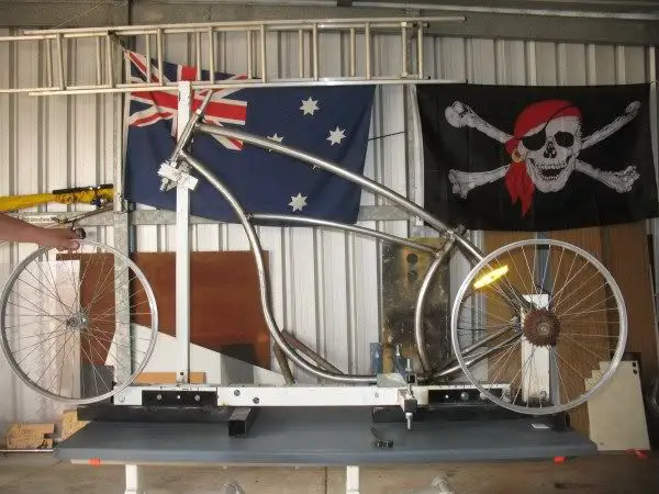

So...i ran out of welding wire went and bought a new roll, different brand and its absolute rubbish as in i can't use it at all its like its not for gasless welding, whether its a bad batch or just outright **** wire i dunno, but it is crap... so pissed as i have the frame 95% welded now, the front half is
fully welded and half of the chain stays.

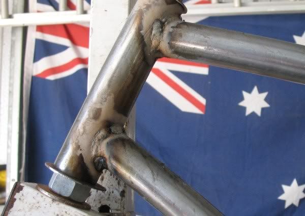

My oldest and best friend dropped in this morning while i was bending the final chainstay,
"Snapper" is a motor body builder and has been for 20 years...he welded my tacked frame up in
under 10 minutes, he would of finished the entire job if not for the wire running out, he was a machine haha...
I should have a new frame to show... as is...still need to weld a few spots on the ass end...
Snapper also bought me up the 3mm steel plate top for my new bench! check this out-->
Nice coat of primer stops spatter sticking, i simply brushed it off when all the welding was done.
OK...few pics of the mornings proceedings-->
Dropouts will be slightly trimmed along visible pen line (seen in first pic more clearly) ...

Have allowed lots of room for chains and BiG wide mofo tires :lol:
Have a few random pics of the welding, required very little grinding, Snapper
insisted hitting them all with flap disk when he had finished though, using the anti
spatter spray it was very little clean up time.
Mocked up with a couple of old rims to have a looksee at how shes comin' alongz

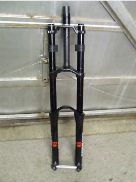

I had my eyez on a set of Boxer 2004 triple clamp forks on EBay but someone snapped them up for buy now
price last night.. :: sigh :: also...I was curious what are the longest downhill fork available
would i be right in assuming 35cm stanchions are up there amongst the longest aside from some of the newer
$2k forks... I will be needing the longest i can find anywayz...

Regarding suspension forks: Marzocchi Monster T's are one of the largest and longest travel forks available for MTB's. They were made up until a couple years ago and can be found used all over for great prices. The Monster T was derived from a Marzocchi Trials motorcycle fork, and come standard with 40mm stanchions and a standard post mount for an 8in disc rotor, as well as a 20mm thru axle of course. There are three types of Monsters you will find: Gen 1 is the 6.7in original model, manufactured from about 1998 through 2003, and is an amazing handbuilt italian fork. Full open bath internals allow for almost infinite adjustment of springs, oil weights, and oil fill heights for individual riders and applications. This fork was one of the first if not THE first MTB fork to also boast external adjustment of preload, compression, and rebound. Marzocchi publishes factory oil weights, volume in cc's and spring rates on their website at Marzocchi USA. The second fork is the 2nd Gen Monster T, which bumped travel up to 8.0in, and is even taller than the OG Monster. Much heaver, but extremely impressive looking, and maintains all the adjustability of the original. The last and rarest of these beasts is the Super Monster, which boasts something insane like 12in of suspension travel, and I think would be complete overkill for all but the most insane of applications, but I would be remiss if I did not mention it here. These were only manufactured for a couple of years before being discontinued in the face of much improved technology becoming more common in successors like the Marzocchi 888 and Fox Racing Shocks Fox 40.
I have an original 1st Gen Monster T which will eventually grace the front end of a Morini build, and it will be amazing. I personally ran a Monster T for a season back in the day on one of my freeride bikes and it was a singularly awesome to ride due to its buttery smooth travel and unequaled steering stiffness.
http://www.marzocchi.com/System/28149/MonsterT_3.jpg
One other beautiful Marzo fork to be on the lookout for is the Marzocchi Shiver, an inverted, 8in travel suspender that was absolutely the fastest racing fork of it's day. It shares nearly all internals and adjustments with the monster, is ever so slightly lighter, and is so doggone sexy I don't know why they still don't make it except to think it was too expensive to make good money on after a while. If you find yourself a shiver you have a fork truly worth designing a bike around.
http://toughguydesign.com/images/bikes_bighit.jpg
KiM
May 5, 2010
301
Australia
Thanks for the detailed info on the forks huckersteve...your the only person on 3 forums that has helped in this department appreciate your time.
Obviously i won't be requiring a high end fork for their performance alone, this is more of a looks deal, im a paraplegic and wont be racing down no mountain trails in this life time on a cruiser or a mtb LoL as such i couldn't possibly entertain the idea of paying more than 400 bucks for a set of triple clamp forks...It is quite a coincidence though huckersteve you talk of the Marzocchi made forks
as just few hours ago i bought a set of Marzocchi Drop Off triple clamp forks for $AU300
(around 280 USD i guess?)
Yes i am aware these are the lowest model/budget Marzocchi fork but they are still Marzocchi's so build quality will be superb i am guessing? Either way Steve, IMO they are more than suitable for the intended purpose. I read a handful of reviews and they got a good rap for a budget fork, i believe ~$US800 bucks when new?
Anywayz, I am absolutely rapt i got these ones Steve they are in good condition and in Australia! so i'll have them by next week not 3 weeks time it takes to get freight from USofA and Europe...if your lucky. ! Have also obtained the length of mates 35cm stanchions forks that also have 160mm travel and checked them against the head tube height of my bike, they will be perfect
the bikes lowest tube should be parallel to the ground as planned.

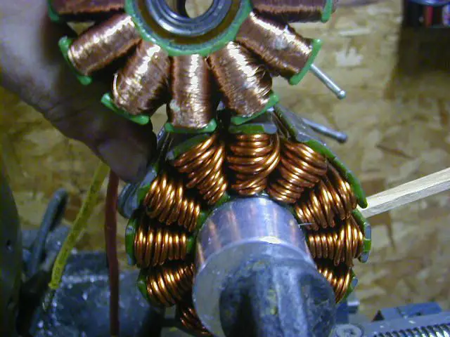

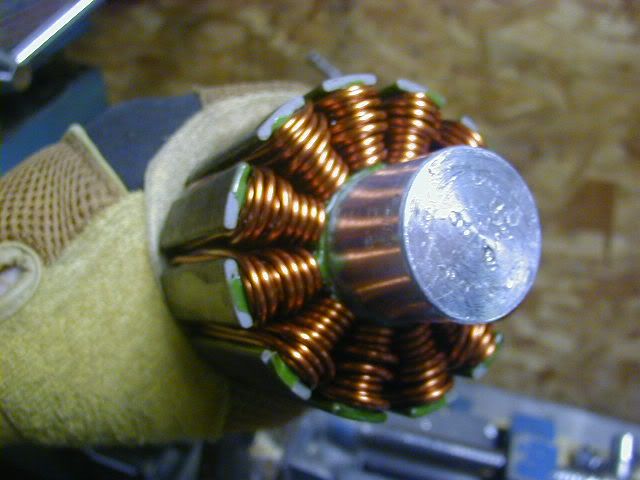

I have also some excellent news to report regarding the Turnigy HXT 80-130kv re-wind, Thudster supplied the following pics of my stator fully rewound with 14awg wire!
Take careful note you might be able to make out the wire is definitely a little larger O.D than
the stock wire LoL
Hold onto your hats here chaps, this wind has bumped the motors kv from 130kv to somewhere in the vicinity of 180kv i let one of the smartest fellas in this area on Endless Sphere
explain tell what this all means... (copied from ES thread "Thuds re-wind of a turnigy 80-100")
