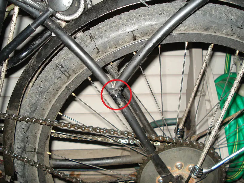

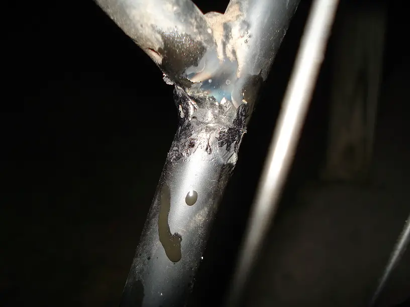

2 years of vibration finally made my frame split and this wasn't even on a part of the frame that's under tension. Do you really want to find out what it's like to have your down-tube or chain-stay split because you weakened it with a hole?
Obviously I welded this back together before I took the pictures, I just noticed it as I was about to leave work tonight and didn't have a camera handy. I only welded the outside, you can still see the split on the inside in the second picture. I touched it up with a paint-marker also because I didn't want it to rust.

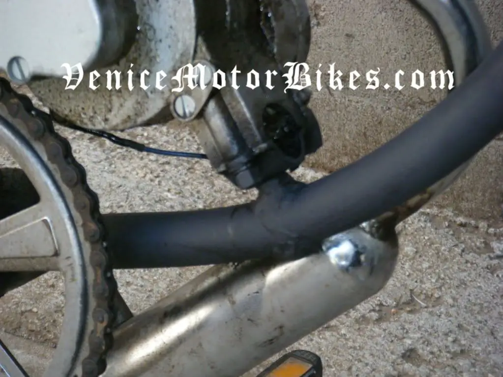

Here's another old pic I found of a drilled frame that cracked (& was rewelded).
There you have it... more proof not drill your frame!
I'll add that after it was welded, it's still working to this very day. :rolleyes:
