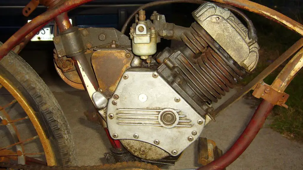

Hay Quenton I'm not sure if you'll see this,or if you remember me From Jb's rally. I had mentioned wanting to fit a Whizzer engine in my Roadmaster. Just thinking this might be a good starting point for a rebuild Quenton style.
The vintage Whizzers had very few problems, because they were made in America and are really well built.
The early "H" [1946/1947] motors used 1/4" head bolts [below serial number H120,000] and were later upgraded to 5/16" because of "blowing head gaskets". It is easy to convert the 1/4" bolts to 5/16", all that is needed is a drill, a 5/16" X 18 tap, and new head bolts.
The majority of vintage motors used an insert crankshaft and if run low on oil, could damage the crankshaft when turning [leaning] corners. The fix was to install the later "tall" breather from the later motors [300, 300S, 500, 600S, and 700] and increase the oil from 6 ounces to 8 ounces in the crankcase.
If you need help locating parts or information, just ask! I have a large supply of original NOS parts and can guide you to collectors/vendors for any parts you might need.

Gutter Rider
May 26, 2011
2,746
5
Left coast
Just gotta put in my 2cents...
I would NOT have waited til saturday!
At $250, what I see in the pic looks like a realistic investment.
Good luck
rc

From my talk with the seller He told me the engine turns over and has compression but the electrics are shot.
I normally rebuild about one Whizzer a week, and will be happy to make your motor 100%original.
Just let me know when you are ready and I will discuss the details concerning the process & cost.
I have all the necessary special tools to make it like new. I have tools to measure the crankshaft clearance, tools to bore & hone the cylinder [if needed], tools to press in the replacement bearings, and special tools to cut the valves & valve seats.
Have fun,

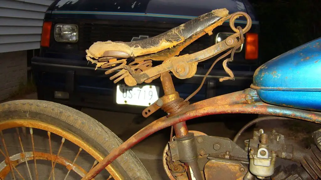

Just got back from picking up the bike. I'm currently charging my camera and will have pics up later.
The bike looks all original except for the bars. The wheels role perfect and the front drum works and the tires hold air. I took it for a quick pedal,and it rode fine I just need to see how much mettle is left after I remove the rust from the rims and spokes.
Also I have never seen the head badge before It says Royal.
