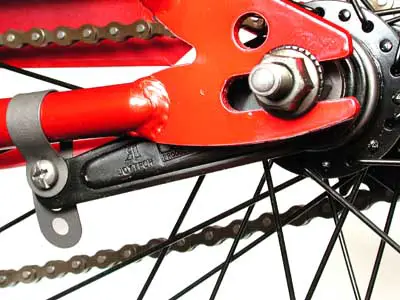

Hey guys, after 3 hours of working on my first build... I ran into some problems.
I did manage to install the sprocket (finally!) But then I had to install what I think was the coaster brake (I have no idea how they work), so I screwed it on, and then put the wheel on my bike... but then this happened:
The coaster arm brake (whatever its called) hits the frame... how am I supposed to install the coaster brake?
Also, is there supposed to be a plastic piece in between the coaster brake's washer and the sprocket? ? I put the sprocket over some piece of plastic that I feel may be important to the coaster brake...
But, I guess another question arises... http://www.youtube.com/watch?v=r_yZb5lnm6U
Is this centered enough, or should I go back and do some more centering?
What is going on...??? Please someone help :(

it looks to me that the reason your brake arm is hitting your sprocket bolts is because you have your dust cap backwards and in the wrong position. the coaster brake arm is installed like so: cone nut, then dust cap, then brake arm, then washer with oblong slot, then brake arm nut. I hope that helps.

Oii...this is so confusing for me because I have no idea what the cone nut or dust cap is (googling has borne no fruit...) nor do I remember seeing anything apart from the brake arm, washer, and nut. Well I do remember this piece of plastic that I put under the sprocket... am I going to have to uninstall and reisntall my sprocket?!? That's going to be terrible!
Is the coaster brake arm supposed to spin as the wheel spins or just stays in place? scratg.spr.
I am going to say this as simply and politely as I possibly can...
Does the fact that the hub has an arm sticking out and the frame has a mounting point and they were bolted together to prevent the brake arm from moving imply that it should be able to move?
Of course not and the bike has a spot do it for crying out loud.
Get the nuts and spacers on your axle right and the brake arm will clear your sprocket blot heads.

You have the dustcover on the wrong side of the sprocket and you ask if the brake torque arm should spin around with the wheel?
