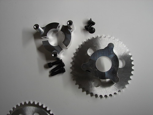

This picture clearly shows my original balanced three piece design.

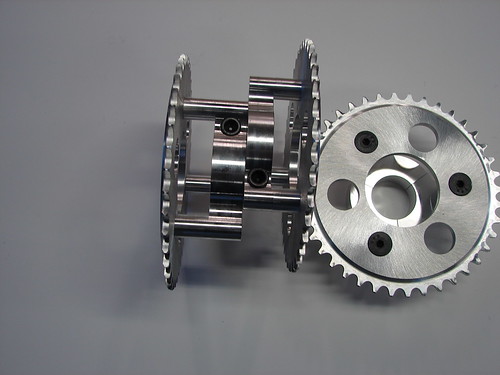

The new production version is on the left and the prototype is on the right. First version was 3/4" wide. Production version is 7/8" wide and has 7/8" standoffs.

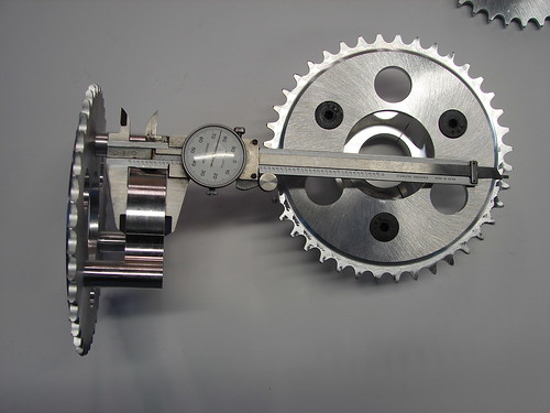

Next picture shows the production version being measured. That's a FULL 7/8" wide. This has more clamping force than any other available sprocket adapter on the market. A true heavy duty adapter.

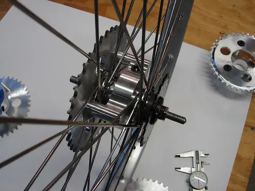

So, can all this bulk really fit inside a 36 spoke wheel with 12 gauge spokes? The true test here is if it fits a Worksman wheel without any interference. Here is the proof. It took five minutes to install. Fits perfectly and clears everything easily. This monster is rock solid!

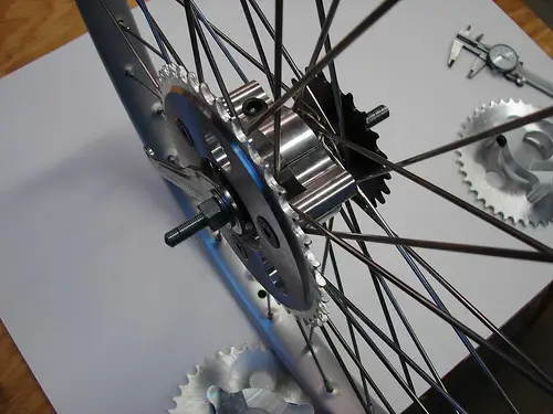

One final shot. Pretty heavy duty, huh? Notice the counter sunk bolt holes on the sprocket and the large center sprocket hole for plenty of coaster brake arm clearence.

btw I think the production version is the one on the LEFT, counter to what your thread states.
And while I'm at it, I have seen these folks, like Pat says, these are super beefy units. The counter sunk heads on the sprocket and the larger hole for brake arm clearance are nice touches and fix problems that I had with another brand adapter that I bought some time back.

after you posted i went and looked at it, i think the reflections of light are making it hard to see.
best angle would be for them to be clamp down, sprocket up on a table side by side, i think that would be the most clear way if seeing a difference.
