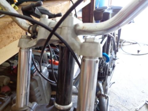

Ok, so this is later whizzer ambassador fork made in taiwan. The seals are shot to the point fluid is leaking on to my disc brake.
I figured while I had it apart I would shorten the length of tubes. Thought it might be easy and I could do it at home. Just wanted to shorten a couple of inches.

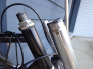

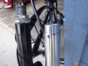

Here is what I have to contend with in pics. The bolt that holds top of triple tree mount and fluid fill does not screw into large part of fork tube. The bolt appears to screw into fitting that I think may be pressed or peened with little tits? Not sure what I"m looking at! What is the name of this method?

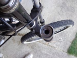

If you look inside small holes in large fork tube there is no threads from insert like it screwed in. If they are in fact nipples in the small holes they are not protruding very far. Didn't want to take pipe wrenches to it and screw up because I didn't know anything, I have done enough of that for a life time.
Any thoughts would be extremely grateful. OH, and there is three holes in each fork tube and also you will notice top of fork tube is chamfered[URL="[URL=http://s1192.photobucket.com/user/skitchfish/media/9d47bba3-5245-4b27-87b7-62c52e31ab90.jpg.html][IMG]http://i1192.photobucket.com/albums/aa330/skitchfish/9d47bba3-5245-4b27-87b7-62c52e31ab90.jpg[/IMG][/URL]"][URL="[URL=http://s1192.photobucket.com/user/skitchfish/media/4cf03ae0-7099-478d-af8a-d2d3a0eb017d.jpg.html][IMG]http://i1192.photobucket.com/albums/aa330/skitchfish/4cf03ae0-7099-478d-af8a-d2d3a0eb017d.jpg[/IMG][/URL]"][URL="[URL=http://s1192.photobucket.com/user/skitchfish/media/634a5550-c67b-43ff-91ea-aebeff9ed296.jpg.html][IMG]http://i1192.photobucket.com/albums/aa330/skitchfish/634a5550-c67b-43ff-91ea-aebeff9ed296.jpg[/IMG][/URL]"][URL=http://s1192.photobucket.com/user/skitchfish/media/87b95088-45d5-4bb7-8f56-72e25bd0f2a8.jpg.html][/URL][/URL][/URL][/URL]
