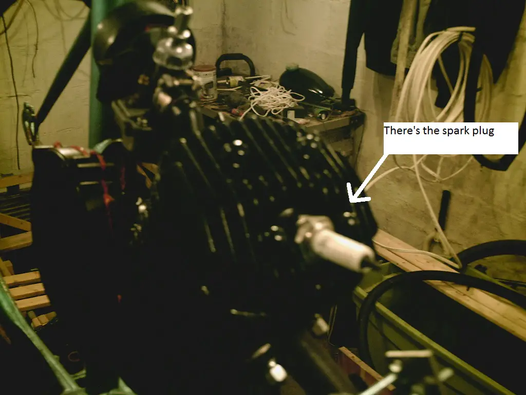

Okay, here's a photo of where to find the spark plug.
The spark plug is what actually ignites the fuel mixture that is in the cylinder, pushing the piston down and generating the force that makes your motor propel your bike down the street. The energy for this spark is generated by a device called the 'magneto' that is mounted right next to the engine's crank-case. Here's a photo of it's location.

You're going to want to start by figuring out if this system is working properly. When you're out buying that two stroke oil you might as well ask the store people for a cheap Ohm-meter. They can be had for about $10. (in the USA. Probably not greatly different in Aus) You're likely to want it. If not now, then sometime in the future.
Remove the spark plug from the head of the engine. You'll need to pull off the wire that runs from the CDI to the spark plug. Then un-thread the spark plug from the engine. Pop the wire from the CDI back onto the top of the spark plug.
Now prop up the bike so that the rear wheel can spin freely. Lay the spark plug down on the top of the engine so that the threads are making contact with the engine. Spin the rear wheel or push on the pedal. The piston should move up and down pretty easily. You should be able to hear air being pushed and pulled in and out of the spark plug hole.
And you should also be able to see a spark at the tip of the spark plug.
If the answer to that is yes, it still doesn't mean that there's nothing at all wrong electrically. But this'll be a good start.
Come back here with your results and we'll help you diagnose things from there.

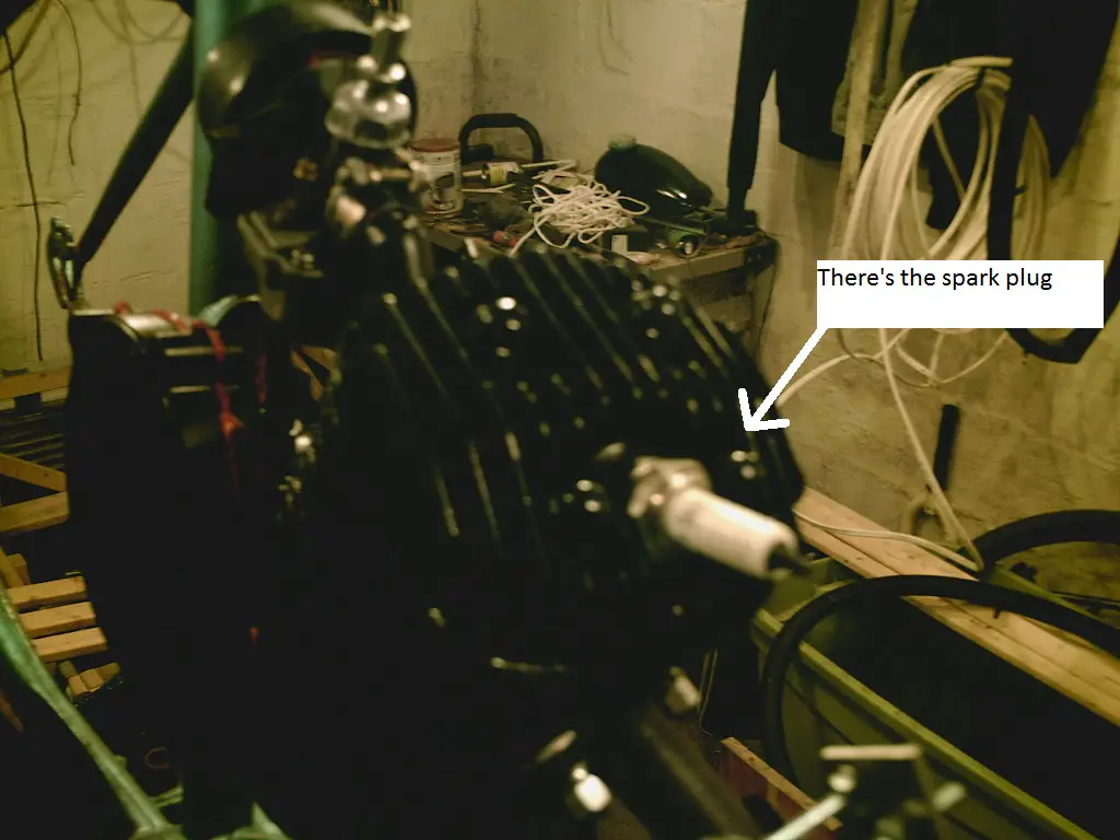

So I will try to check the sparkplug next. I removed the wire connecting the magneto to the sparkplug however I ran into a bit of a problem and I wanted to get some advice before proceeding.
I've taken a picture of the sparkplug which I've attached below. The sparkplug is this white thing, right? How do I get it out, do I need to turn the sparkplug independent of this gold bolt below it or is it attached to the gold bolt and I need to turn the gold bolt to remove it?
I tried turning the gold bolt and it is really stuck; if I'm going to remove it, I need to purchase a sparkplug wrench or something; I have a ratchet set but the bits won't fit over the sparkplug to get at the bolt. Is there a standard size for these sorts of motors for a spark plug for purchasing a spark plug wrench or will I need to measure it for my bike?
Before I do this, can you confirm if I'm on the right track here? Should the bolt be this tight? I tried removing it with pliers and I couldn't budge it but I also didn't want to force it
And thanks again for your help. I know you have better things to do than take pictures of your own bike to help me out and the effort isn't lost on me.

Theon is right about that. An engine only can be bought, but a new kit is not a whole lot more expensive. And then you have spare parts. That's how I've done it. After building a bike I order a new kit. It goes in the attic waiting until needed.
Anyway...yes...that 'gold nut' is what you want to turn, counter-clockwise, to get that spark plug out.
I'm a bit worried about the fact that you couldn't get it out with just pliers. Though that should be done only very carefully when needed. Still, it should have done the trick.
It could be that that engine got so hot that those threads are 'welded' in place.
Still, it's worth trying to get that out of there. When you do try turning your pedals and see if the piston goes up and down easily. If the answer is no, then that'll be a good indication that there's been damage in there.
