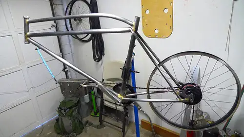

wileydavis
Nov 22, 2010
45
Bozeman, MT
BTB: I may have done something similar to what you're thinking. I used a staton gearbox and a freewheel and crank from sick bike parts (just their crank, not a shift kit). The gearbox is 18.75:1 reduction. On the output of the gearbox I have a 14t freewheel chained up to a 48t chainring at the crank. This gives me a ~64:1 reduction between engine and crank. I like to pedal between 90-100rpm, so that means when I'm pedaling at my peak, the engine is near its peak as well (~6400rpm). The other chainring is a 36t and is connected to a nuvinci N360 with an 18T cog.
The end result is a bike I can pedal assist at all speeds between stump-pulling and 33mph or so if the wind and hills aren't against me (EH035 engine). I've got about 2000 miles on this setup so far and have had no troubles with the exception of blowing up cheap (ACS) freewheels on the gearbox. Once I switched to a White freewheel, I've had no troubles.
here's a pic of the frame in construction showing the drivetrain arrangement:
Frame With Freewheeling Crank by practicalpedal, on Flickr
