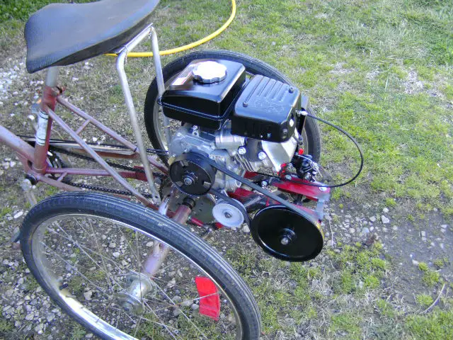

Started a trike, never have done one so figured its time. Based on a 1953 Schwinn step thru. Found a NOS bare conversion for cheap on ebay. I already had a 36" 5/8 keyed axle and precision bearings so this worked out great. due to the strange nature of the build I need all the clearance I can get around the rear drop outs so decided to weld the conversion after trimming the forward arms off. To decrease the load on the rear triangle I will be adding stout bracing from the outer axle tubes to the seat post area, like seen on many older trikes. Rear seems narrow so will be spacing the wheels up to 4" with some stout wheel spacers.
Power will be a 48v 500w wheel motor that I may under volt to keep speed down. I motorized a trike for my son using an HF 79cc. Thing was scary over 15mph. Was probably just that trike. Any way waiting on parts so not much more to do til they get here.
