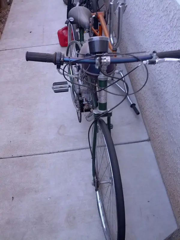

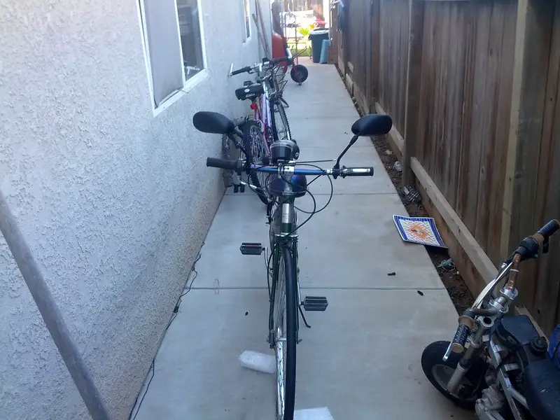

I really it like the green, I think it goes good with the color shifting purple. I think your bike looks great, maybe if you plan on running a chain gaurd paint it color shifting purple to tie it all together? I have the same AMF fram I may use for a future build. If I was going to nit pick your bike I would say maybe try to clean up the cables and wiring a little? I know from working on my bike that is easier said than done!

I would add a springer to the bike, you'll notice a much smoother ride as it will absorb a ton of road vibration. I had an AMF frame similar to yours on my first build and used a Sunlite springer from Pirate cycles. Also would advise a hub adapter if you can find one to fit the rear wheel. If the bolt gives out on the exhaust and it falls apart see if you can find someone to weld it at the end cap, mine kept coming apart even after using some high temp threadlock. Great build!
Also, I saw that someone mentioned it before but I'll repeat, get yourself some front caliper brakes on there. A local bike shop might have a simple set or even Wally World / Target.
Thanks Darkhawk! I actually read your build thread with the AMF a few times just to see what I could do to my own bike. It is definitely a work in progress but it will certainly get to where I want it to be. Front brake is definitely on the "to get" list.

Thanks forrestsmith! I've been meaning to get to the cables and wiring. When it comes to working on the bike it just hasn't been a priority but I'll probably get it done this weekend since it needs to be done.

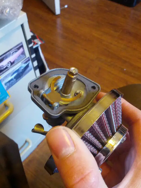

Long time no see! I've been away from these forums and my bike for about half a year due to working in Yosemite National Park over the summer. Finally got to pull out the bike today check her out. FILTHY! Need to clean her up and get her back on the road.

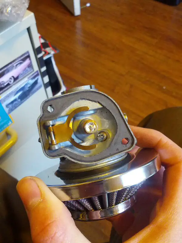

Pulled off the Carb and opened it up, float bowl gasket is shot. I need to figure out how to replace that. Other than that, just a clean up, fuel and it'll be ready to go!

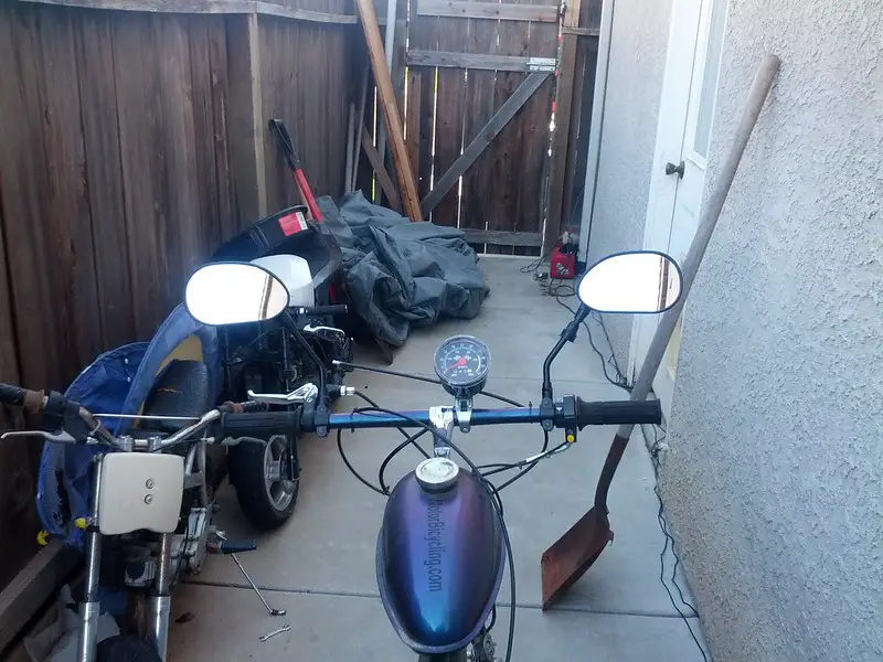

Couple updates on the bike. Got some gasket material and made a gasket for the float bowl.

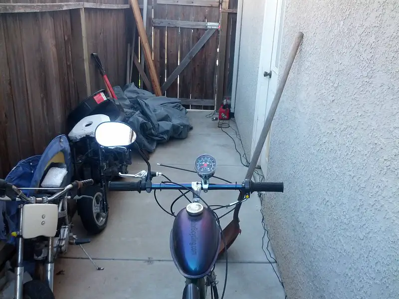

Also got some mirrors from amazon for pretty cheap. Test fit the left side for now. contemplating putting the other side or not, thoughts?

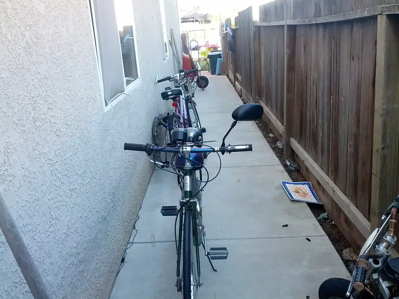

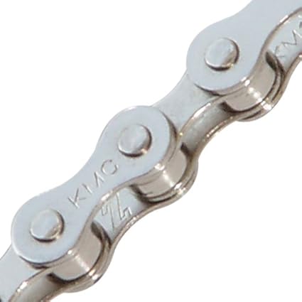

you really, really do not need a chain that big. I argue this because your bike is a very "small" bike. that chain in your case will do nothing but increase vibrations. It may look pretty but I highly suggest a smaller chain , namely a "BMX single speed chain" There are numerous colors and styles to suite your needs. I do not suggest using a "missing link" variety of chain because you cannot simply remove the link to change tires or whatever, you have to remove and replace them because "they are not reusable."

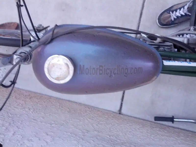

Other than that, I like your build. needs more green paint on the engine. also.... try to do something about that gas tank. With a bike like that you could get away with a tank the size of a 24 oz monster can. I'm just sayin..
Had no idea I could get a thinner chain. I just went with what has been recommended as a good, higher quality equal to what comes with the kits.
I do want to paint more on the bike.
As for the gas tank I don't have any real plans for it. I like the amount of fuel I can carry now because when I take this bike I usually go for a round trip of 20 or more miles.
My goal for right now is to ride it around for now since I haven't been able to ride it for about 8 months. Then make it as reliable as i can by adding a disk brake and hub adapter. Then I'll be able to splurge and start modifying other things like paint and fabrication.

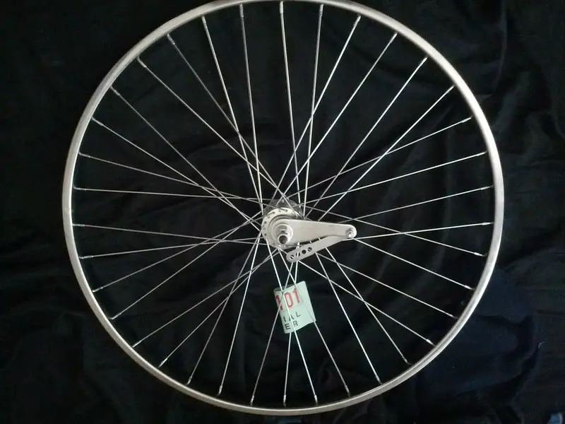

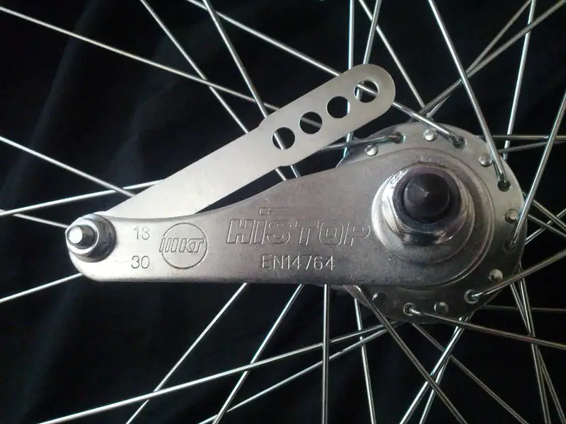

Got the rear wheal today. It has a Histop Coaster brake on it, the wheel itself is by Wheel Master, on the tag it says the hub is a CB CP 110 so I'm fairly certain I need the CB110 sprocket adapter from pirate cycles.
