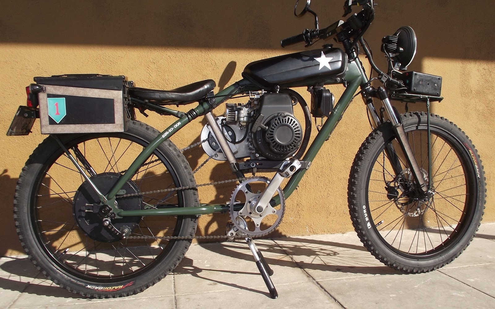

97cc of Flathead Fury! I'm now riding a rolling space heater!
miked826
Aug 6, 2011
1,748
7
Los Angeles
Top Speed: 34 MPH @ 3400 RPM (governor removed) on a 50 tooth sprocket.
Idles at 950 RPM to no ill affect.
My bike is now a thumping, grip shaking, rolling space heater. Man this thing puts out some heat. LOL

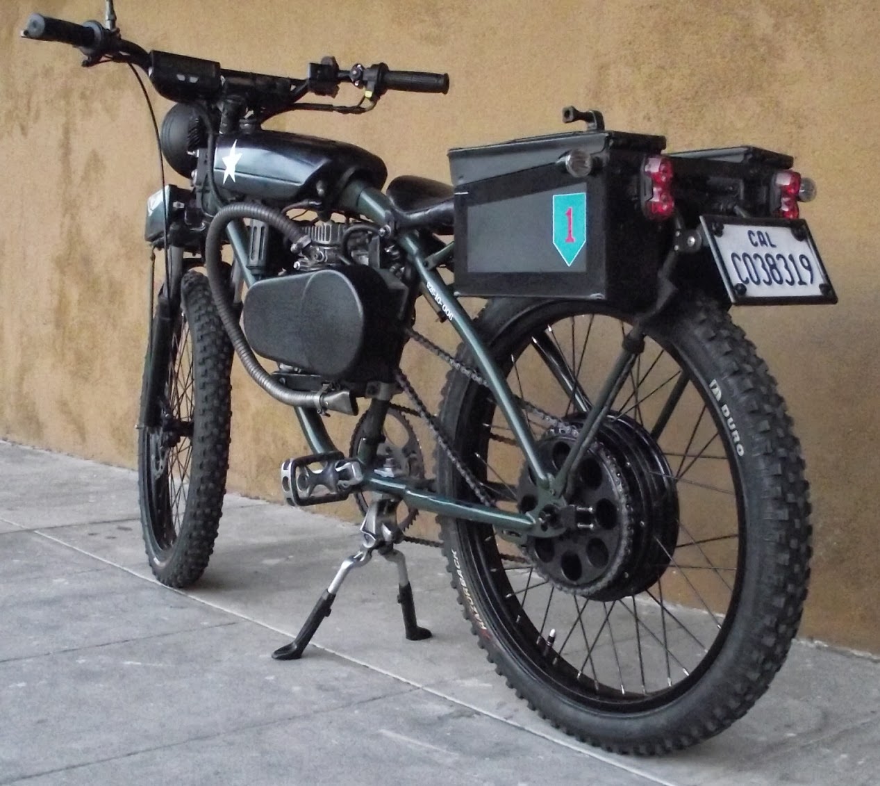

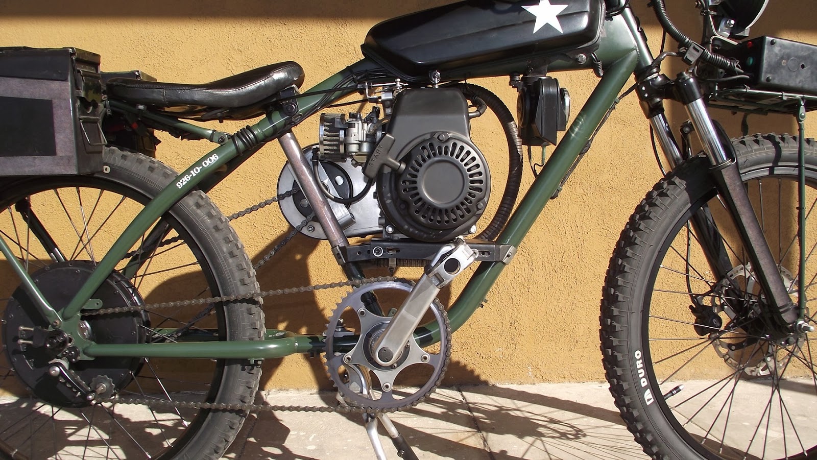

What did I have to modify to swap out a already mounted HS49 for this thing? The crankshaft was shortened and diameter reduced to 5/8". Mounting plate for the engine and the EZM QMatic were both butchered with a Dremel Tool to line up the holes with 97cc Lifan. Exhaust flange holes were redrilled. Carb was swapped out.
Was it worth it? I'd have to now say yes, after riding it a while.
miked826
Aug 6, 2011
1,748
7
Los Angeles
This 97cc engine fits in the exact same size hole in your bike frame that a Huasheng 49cc fits. It is much wider than the HS49 but it's also cheaper or the same price as the HS49. Had I known about these facts before buying the Huasheng, I never would have bought the Huasheng. It just doesn't make an ounce of sense if you compare the two motors, spec for spec, pound for pound and dollar for dollar. Plus the 97cc just sounds hellacious compared to the 49cc. With a free flow exhaust it sounds like a real motorcycle idling. I swear if you stand close enough to it you can feel the ground shaking. LOL
