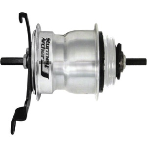

will a sturmey archer 3 speed hub hold up to motored biking?

Increase the chain speed/rpm of the tranny which reduces the torque loading, and it will never explode.
I have almost a thousand miles on my shimano tricycle transmission as jack shaft. THere is no sign of trouble or heat.
I recommend the nexus highly over the SA. I crank out 40mph with the shimano in 3rd gear.

For the one who questioned about how to mount a sprocket to the SA for jackshaft use- I welded a bike sprocket on the other side, being careful to center it and use little tacks of weld to avoid wrecking the brg, race which is close to the welds.
Only issue is the dropping out of gear monentarilly in 3rd, I put a slightly stronger spring in the hub (pretty easy- just place hub in vise by the axle with the shift side up and unwind the nuts and brg race- spring will pop up) - this does help some.

As others have said should be fine with a HT motor...just dont try using them with medium to hih powered electric setups, my extra wide sturmey archer 3 speed started skipping gears first ride not 20 foot out of my drive way they definitely weren't made for 10 000watt motor driving through the hubs sprocket, fixing a sprcoket to the opposing side on the disk brake mount and driving the hub would be fine though i actually run a disk brake and a south paw freewheel on the left side for the manual pedal of the bicycle :)

Beg to differ all you like fact is these 3 speeds were blown up not while shifting, mine and my friends extra wide three speed sturmey archers and the above mentioned nexus of Deecs all failed while in gear NOT when shifting, the torque snaps the teeth off the gears while in gear... If your pushing more than 1000watts through these 3 speeds they will fail whether you baby them through shifting or not... Using them on HT motors you will likely have a long life, the motors don't have the torque to pull the skin off a bowl of custard. My warning was a heads up to those using moderate to high powered setups, morini could possibly fall into that category. Any electric over 1000watts definitely falls into this category IMO.

6500rpm can't tell you exact torque figures max of 13hp it is under geared far from ambitious to cope with the extremely hilly terrain where i live i also tow a wheelchair behind the bike most times i ride, acceleration is 0-55km/hr in `4-5seconds(while towing wheelchair)
