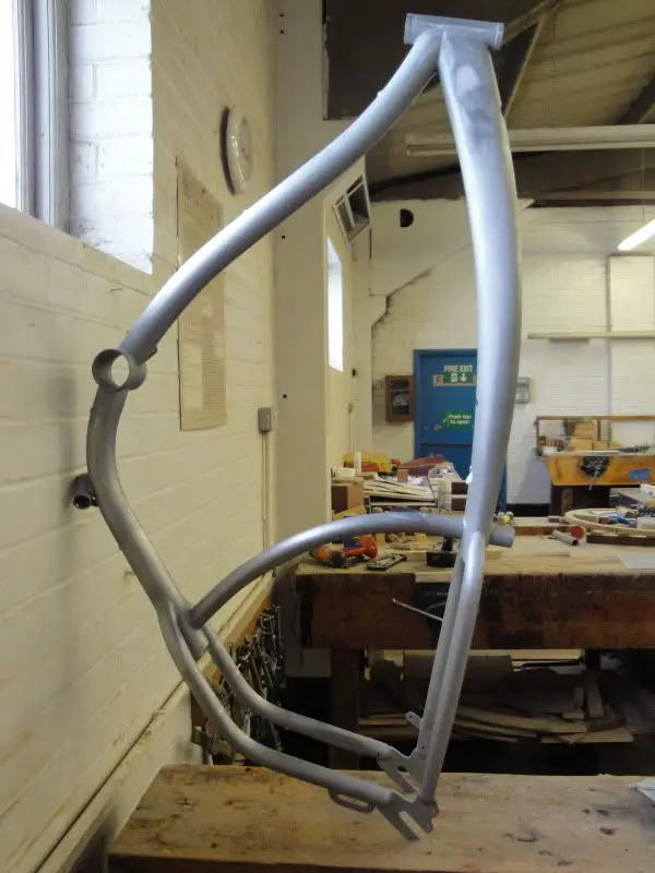

O.k. I have searched the forums, but I am still none the wiser, how many holes on a Switchblade are there to fill. I can see one inside the headset which should be easy to get at but where are the others.
I believe the correct way to plug the holes is to clean the area with thinners, push some wire wool in the hole and fill over with J B weld.
J B weld a female brass connection in the top tube for the filler and add a vented brass cap.
Weld in the gas outlet tap?
Seal tank with Kream or similar.
How am I doing?
Any suggestions would be great.
Cheers Jim

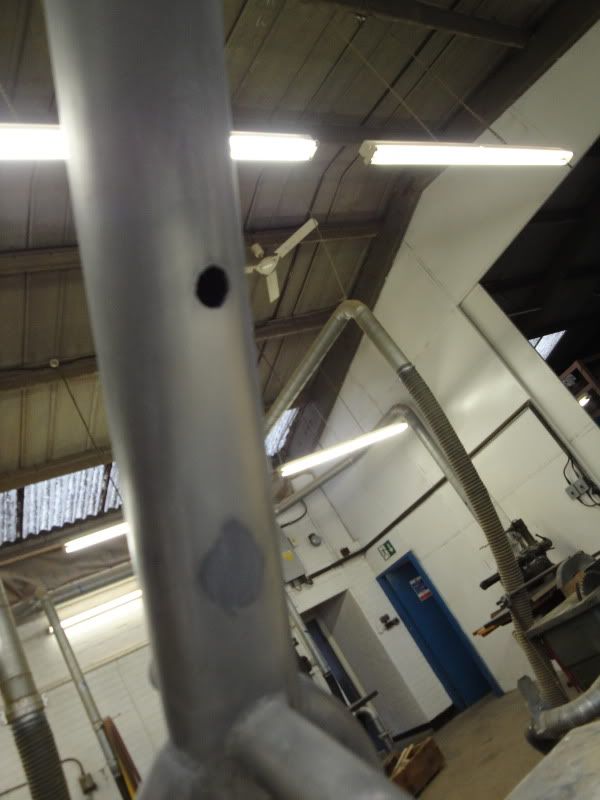

You must seal the inside where the top tube meets the down tube or gas will pour out the bottom bracket!
You also must seal the top tube completely IN FRONT of the seat post tube because there are two holes in the SP tube & in the seat stays that will have gas flowing out near the rear axle!

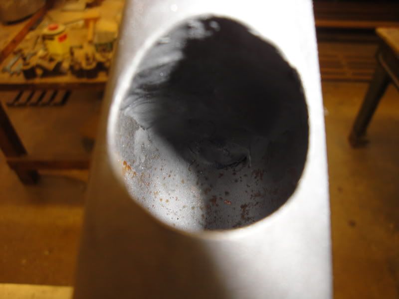

Ok, I have cut a 25mm dia hole in front of the seat post tube, stuffed some wire wool in there, stood the frame on its end and smeared some J B weld over the wire wool. I shall leave it over night to see if it sinks, if it does I will put some more J B weld in there. Now what is the best way to cover over/fill the 25mm dia hole I have made?
