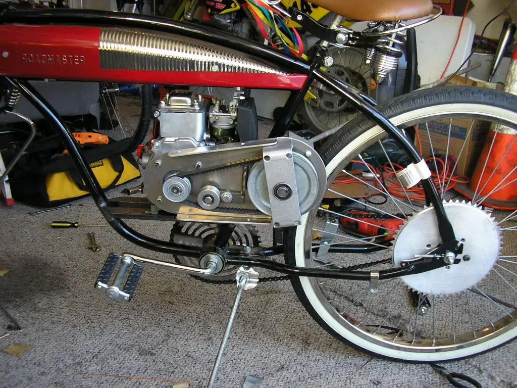

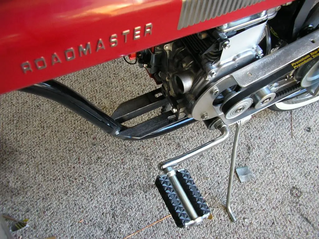

chainmaker
Jan 19, 2010
2,634
69
48
Ma USA
This isnt my bike, but FlybyTaco ( where is he these days?) welded mine and this one, with just some angle iron and it was super solid. Just measured for holes/slots, and drilled.
