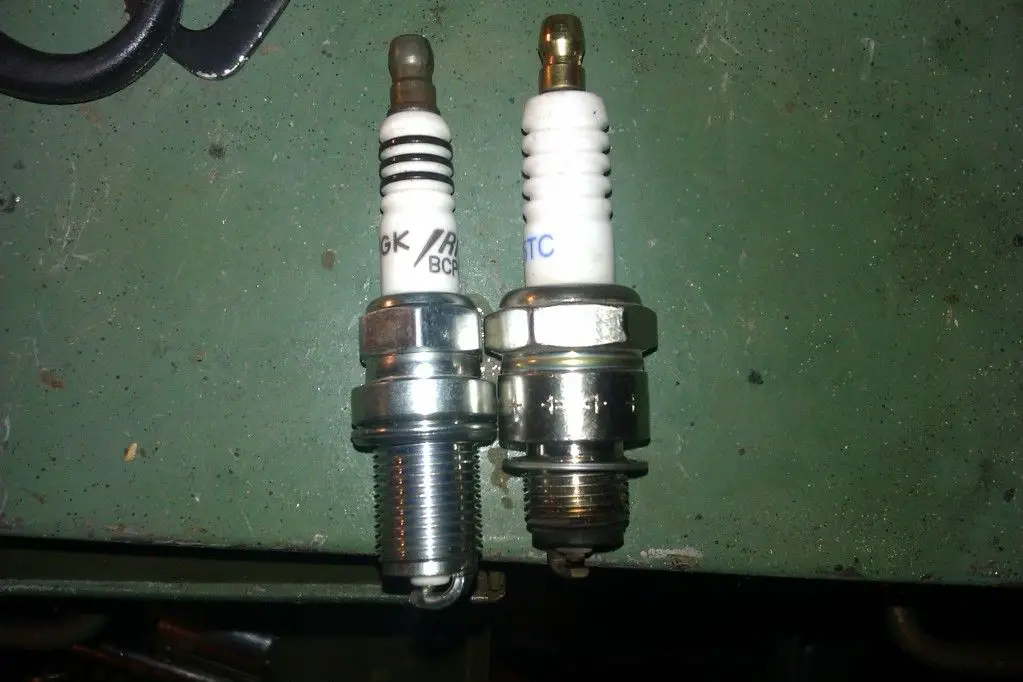

plug 4919 a little off from the stock plug in a 99cc predator as can be seen from my pic .
so im considering a couple washers to raise it out and even it out .
