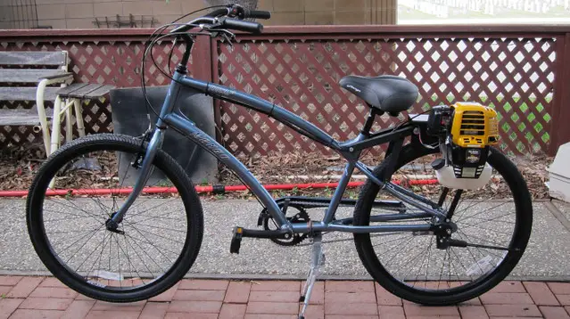

First test drive last night :) Recieved my Staton Inc Friction Drive w the Subaru 35cc kit Friday and installed it that night, just a one modification to allow the back tire to spin under the u-bracket and I was good to go.
bought some synthetic oil and started her up for the first time saturday night... she started w just two pulls and runs quiet and great... wife and kids had a blast riding it too
saw a police speed control radar in my neighborhood and the temptation to test it was too much :) anyways it "clocked" me at 29mph xct2 not bad for barely full throttle (since I still need to break it in)
big thanks for the earlier suggestions... i am very happy w my kit/engine

Good to hear it's working out, mine's on order, should arrive Tues / Weds. What size roller did you go with? I ordered a 1" as I'm heavier than most and want the ability to go up a hill once in a while.

Synthetic oil is not good for break in. It eliminates too much fricton, keeping the rings from seating quickly and well.

-bigkahuna: i went w the 1 3/8 inch roller, i live in miami so there are NO hills and i plan on pedaling to get her started each time so it works... you prbbly went w a good roller for what u need
-wayne: would you suggest to change out the synthetic for some conventional then? or would it just take longer to break in?
