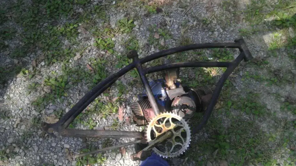

Well I've been collecting a ton of parts for my next build. This one is far more ambitious than my first build but that's the way I like it. Here is the candidate for the build.
It's an old Rollfast I believe. Not sure on the year or model but it was cheap. Hopefully no one gets mad it's going to get chopped. Now for the interesting part of the build...the engine. I debated using a 5hp briggs for quite a while then stumbled across something I've never seen before.

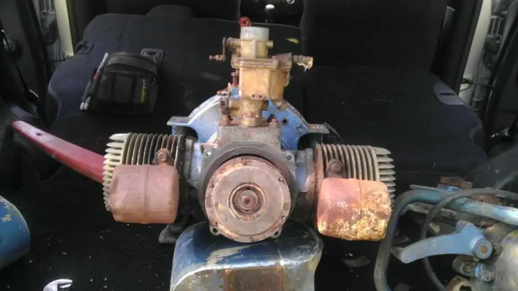

It's a 300cc opposed twin 2 stroke engine from a 2 man chainsaw. A Titan Blue Streak. Picked it up off a buddy for $30. The internals are spotless and I cannot wait to fire it up.
So far I've disassembled the bicycle and have slowly been stripping the unnecessary weight off of the engine and have made it far more manageable to attach to the bike.

Very cool engine! I bet it sounds awesome too! Two stroke multi's have some of the most hair raising exhaust notes of any engine type.
Remember the H-2 Kaw's?
RD-400's?

KOOOOOOOOL. Kind of reminds me of the old Monark twinn i use to have.
Douglas motor cycle has a twin like that...............Curt

The Harley Model W was based off of the Douglas Twin. The Harley made about 6hp. This one made 10hp at least back in 1947 when it was built. I'm not concerned about top speed. Hoping I can make around 50mph while reliably climbing hills. I live in a very mountainous region. I plan on fully registering it once complete. Friday I'm removing the cylinders and cleaning the carbon build up and if all goes well ill be uploading video of it running. If anything breaks though I'm screwed. Haven't found any spare parts yet.

I can just imagine what that engine would sound like with twin pipes, baffled of course, running out back on either side. Oh yeah. That would be cool.

I don't want to disappoint you but that motor will ripe the wheels off the bike. I had one just like that on a mini bike in the 60s it was a mercury 2 man chine saw it had HP they are so powerful they will tear up anything you put on the bike. Mine was only 250cc at 12 hp it would do wheel stands at the crack of the throttle. You could not build a bike frame to hold the power.

Your fine I've thought about that quite a bit actually. If it breaks no big deal ill build a stronger frame. I have a general idea as to what I'm doing but am totally up for suggestions. we will be strengthening the frame along with stretching it to make it more stable. I'll also have better wheels, brakes, some front suspension at least. We will see what happens lol. What's life without risks?

You could ask Tom about his exsperience with the Mercury engine in a go kart. They would go 90 to 100 mph. Their is some vido on you tube of these motors if you want to check it out.

It had a transmission so to speak. At first I thought it was going to have to sit sideways thinking the gearbox was part of the crankcase. I removed it to find it wasn't and that shortened the engine quite a bit. I haven't thought about a clutch yet. It may end up with a torque convertor. I've only gotten as far as a basic idea and some parts. That's why I love this forum. Learn awesome ideas every time I visit.
