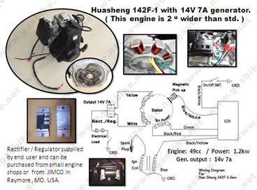

according to the pictures and diagrams,the CDI/ignition system looks like its separate from the "generator system" if thats the case how is it robbing the engine of that much power? or to justify that these kits are that much of an issue.

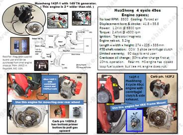

Well, considering the engine is rated for 1.2KW and it dedicates almost 10% of that to the genny, that's a significant take from the engine's output.
Electrical generation always "robs power". The HS doesn't have much to spare. Also, the genny motor is 2" wider than stock! That's alot IMHO.

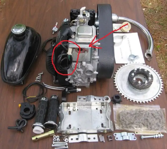

The one in the pic doesn't look any wider than My HS.
When the ad says "wider" , it doesn't specify on which side.
I think he meant engine is wider looking at it from the flywheel end, because of the space taken by the extra coil in the shroud.

imo,id agree with you if there was a belt driven alternator attached or even if this gen was tied into the electrical for the spark plug,but its a stand alone item sitting in there separate. i couldn't think that there is that much magnetic force "braking" the engine therefore to rob power from the engine.to me thats like the same thing the mini gen sold on ebay for the 2 cycles does,and ive never heard of them causing some kind of loss in power.
as for the 2 inches wider issue,thats not bad, i mean for what its worth,ill find away to get it to work,its not like 4 or 6 inches wider id have to deal with.2 inches could be as easy as shaving down a shroud,or spacing out the crank,or whatever. where theres a will,theres a way.

I don't think it is2"wider between the pedals. The extra coil makes it wider on the other axis, from the seat post to the downtube.

Looks wider as mounted between the pedals to me. How else would the generator work without being driven by a belt or chain?
The intake and exhaust stick out over 2" from the engine.

Well, it takes power to make power, and some is lost in the conversion. The HS with the genny is rated at 1.2KW while the standard HS is rated 1.5KW.
That means the HS with the genny has 20% less power. 1.6HP vs 2.0HP. So it appears to lose 300 watts of output to generate that ~95 watt genny.
I feel a significant difference between a GXH50 and a regular HS, and there's a ~20% difference in rated horsepower between them.
Hence, that would make the HS w/genny much slower than a Honda!
Well the coil is mounted in the same plane as the igniton coil to use the same magnets, just opposite of it. That's where the 2" is. It don't have a chain or belt drive.
The ad said the "engine" was wider, nothing about the exhaust.
I have one of these engines in my possesion to compare to the photo.
They are about 10" wide with gearbox.
But see, I said that as an example. If you claim the engine is wider in that direction, the exhaust and intake already stick out at least 2" from the engine.
So is this genny supposed to stick out 2" beyond that? Prolly not, so this engine will likely be wider between the pedals.
You have a genny engine? Or you have a regular Huasheng? And which one?
I have a standard HS 142F with the "Honda" 4G, and it's on a SBP shift kit with widest spindle they offer.
With 4G cover on, the crank barely clears the 4G side, and the circle is just under the widest point of starter assembly.
The full HS+HS 4G is almost 1.5" wider than my setup. Many pedals won't clear. I would not want to think about 2" beyond that!
Anyway, I'm not trying to spread FUD or anything here. I'd love to see one of these HS genny motors, but there's obviously compromises.

Well, it's obvious to me that the shroud in the genny pic sticks out from the engine block in the pedal area about the same as my non genny HS.
The generator coil mounts to the SIDE of the flywheel , opposite of the igniton coil to work off the same magnets that the igniton coil uses not in front of it. Logic alone would determine that there should be negligable difference in the pedal area.
the engine is wider towards the front of the bike about 2" in the coil area only. nothing to do with the exhaust area.. The exhaust still sticks out more than anything else on that side.
