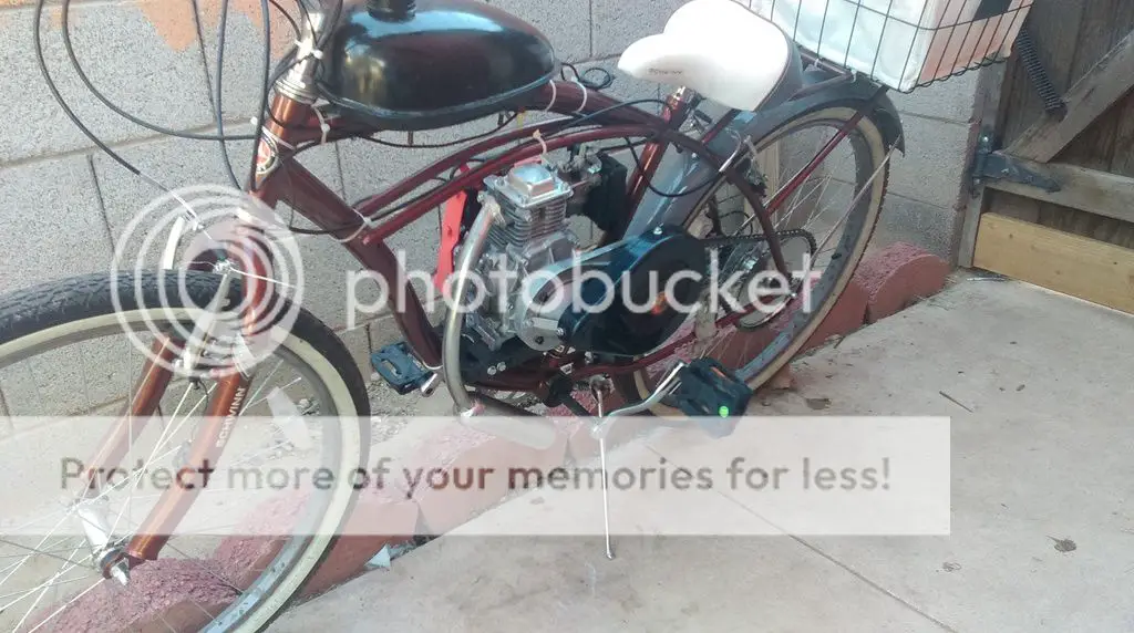

gears are 20 tooth pulley to 100 tooth pulley to a 12 tooth sprocket to a 48 tooth rear sprocket and i can only hit 29.2 mph and it kinda sounds like its rev limited but im not sure where can i get a non rev limited cdi
30 MPH is a good speed for a 49cc engine.
Your engine is not rev limited, it is power limited.
Max Power is at 6800 RPM, max Torque is at 4500 RPM, it likes to run between the two.
Once you hit ~30 MPH wind resistance is a factor, you need a bit more power to fight it, or you need to get aerodynamic.
A good combination for more power at 6800 is an NGK 7544 (CR7HIX) Iridium, and replacing the box exhaust with a pipe.
For more speed and low end performance it's gears baby, this does 38 MPH even up a slight hill with those 3" tires using gears and those 2 upgrades.
In short, efficiency gives you results, not trying to make the engine spin faster than it's internal parts can take.
