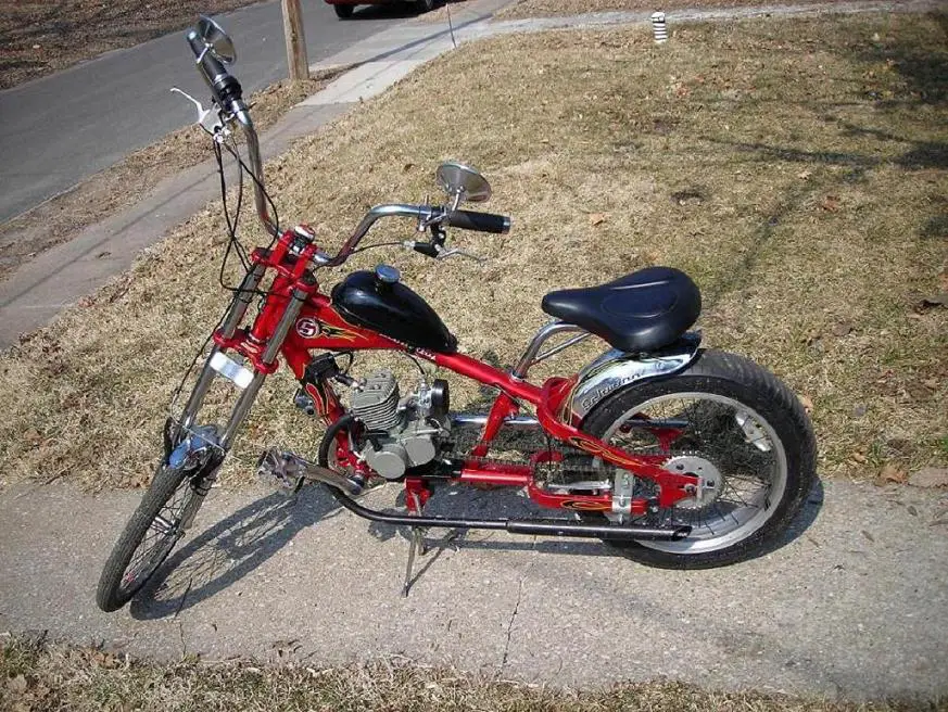

yeah expensive is right. If you have the skills you can weld up your own engine mount, but really, buying one already made is probably the best option....less headaches.
the drag pipe is expensive too, so I made a long drag pipe out of the stock pipe and a $30.00 long pipe i got off e-bay.
the long pipe (sold by b.g.f. on e-bay) will not fit an o.c.c. i it's stock form. the part of the pipe that bolts to the engine needs to be extended so that the pipe will clear the bottom bracket and the cranks.
whatever you do, please find a better looking gas tank for your o.c.c. because the stock kit gas tanks look hideous on an o.c.c. in my opinion.
here's my o.c.c. with my custom made pipe, and my custom made gas tank.

Hi and thx for the info....Your bike looks SWEET!! I love that custom gas tank and I do agree with you on that the stock one supplied would probably look like crap, but I don't know where to get one. Did you make this one yourself?? Or did you buy it? When looking at the pic of your bike looks like you used one of those extended adaptors I have seen that supposedly also help with the performance. Also. did you do anything to upograde your brakes?
dragray
Mar 10, 2012
278
2
Indiana
well, as for the tank, it was a combination of both.
I bought it off e-bay (it's from a jesse james chopper bicycle). Then i had to do a lot of work to make it functional and look good.
I have a lot of time doing body work on the tank to smooth it out.
extended adaptors ??
what are you referring to?
My brakes are stock, rear caliper only but i slightly modified the brake caliper so it wouldn't interfere with the drive chain.
