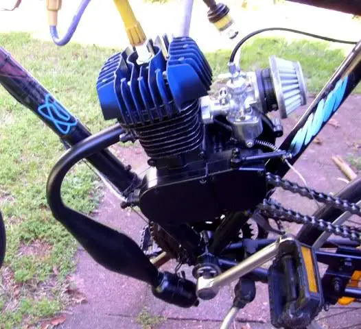

I have an f80 on one of my bikes, it been a great motor and the speed carb suits them very well. For a small amount of money you could get a Poch head way better than a slant head performance wise, imo and has much better cooling. The only problem is you will need to redrill the holes on the poch its well worth the trouble.hope this helps.
F80 Poch head ,modded speed carb + much more internal work

hey man that head looks different.. definatly has better cooling by looking at it, and that expanshion chaimber.. is that one of the ones similer or the same to the ebay ones they sell for 50cc motors ??? it looks like it if so i might try one and see how we go as for major head mods and all that stuff i might stick to stock stuff but maybe mill the head down a bit and definatly a carb,, i dont wana go to crazy as this thing is mainly just for fun and turning heads! most people like it and theres nothing better than screeming past a cyclist in his lycra on a sunday morn without pedling as i mentioned above i recon these things need an extra gear i found they make shift kits for these now these definatly sound like the go .. here they are here Sick Bike Parts LLC - Performance parts for your motorized bicycle but are there any available in australia
