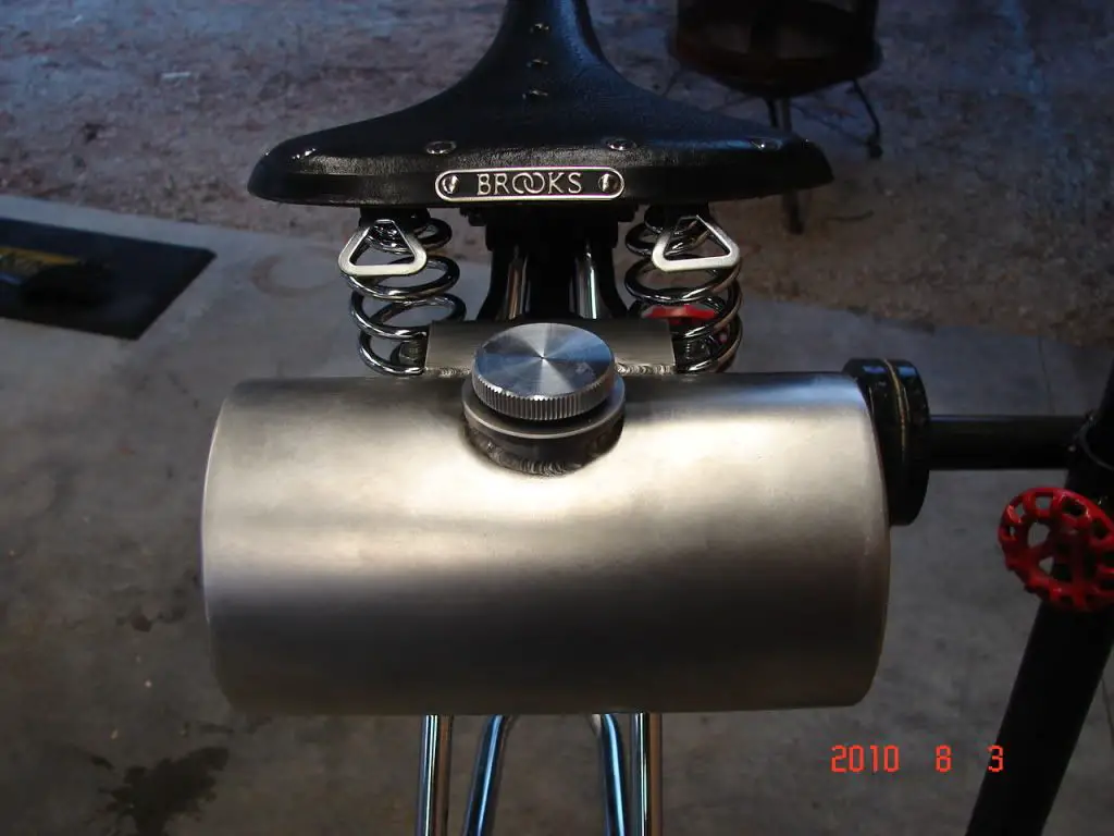

Just about have my underseat gas tank design finalized. It mounts to one of my layback seat posts. All stainless steel tank construction tig welded together with a chrome moly seat post. End caps and bracket are CAD designed and laser cut. Cap is vented with a check valve and bung is stainless steel. I also have a few other mount systems I am working on.

Looks great!
Prices?
You should make one that allows for normal seat mounting too.
(weld a post going vertical continuing the post that goes into the seat tube)

You can just slide the seat all the way forward to put it in it's normal position directly above the seat post frame tube, then trim the excess horizontal section of the seat post to tuck the tank back up against the seat. Trim the post with a tubing cutter. Lot's of ways to set it up!

Thats a beautiful solution! Would that work with a 13/16" seat post? I've been looking for both a lay back post, and a behind the seat tank.. so wow!

I can use a 13/16" post for the vertical section of the post and a 7/8" for the horizontal section, so to answer your question, yes it will work for a 13/16" seat post as long as I know ahead of time.

Cant wait til your site is up so we can see your complete offerings besides a teaser here and there.
Nice job on the tank!!

It may not be worth the money to you, but I have an idea how much work went into making it and how well it is finished off. Some will get sold for sure. I have an in frame tank Pat made for a Schwinn Panther, his first one and made of stainless steel. It was part of a fire I experienced a few months ago which melted engines, warped bike frames, wrecked tools. Other than the paint and decal, Pat's tank is as good as when he made it.
Not everyone wants or needs to carry a gallon of gas.

CAD designed, laser cut stainless and formed parts, tig welded, $30 stainless bung with machined aluminum cap with check valve and a solid two hours labor. It's actually a good deal at $150.
