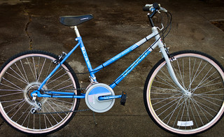

This is my project bike, for the moment:
I know it's not ideal, especially for a china girl, but it was sold for $5 due to a mis-adjusted derailleur, so I'm pretty happy with it :)

I once saw a photo of a china girl mounted on a step-through frame. I don't think it was a fake, either. So it would seem that it can, technically, be done.
Still, I wouldn't advise it. You will burn yourself on that engine. And it might not take long. And it might happen often. And there are other issues easy to see and, perhaps, others that are not as obvious.
You could still make it work and it would be a neat achievement. But you probably oughtta take the china girl off the list of possibilities.

It will require a little more skill than most builds - but your frame looks to be a regular v shape so it should actually prove very easy to mount a motor. As for the carb - as long as you dont run the tank very low a very small drop should be enough to feed the carb.

Biggest issue I see beside tank mounting is the chain line clearing the rear stays. I have a LaJolla womens cruiser I'm dying to slap a ht on, but the motor mounts so high on the frame that the chain would hit the rear frame stays without major modification.
Check things out before you decide on the ht.
