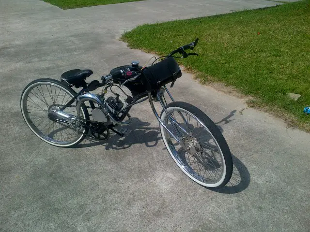

I have found that just about any bike with 26in wheels and no rear suspension will accept a china girl engine. I have even built a 24" huffy mountan bike with sucess. I did have to get an offset intake and use the slant head to wedge it in there as well as loose the front derailer. As far as maintenece goes cheap china kit parts are deff gonna break esspecially if you ever mess with anything, and you will its unavoidable. What I did was buy a cheap kit and over the last year or so have upgraded about everything that cae with the kit. Also a bit of advice about the tensioner that co$es with the kits- ditch it if at all possible - it will save you tons of grief later. Here goes a pic of my current build with all the upgraded parts ;)
