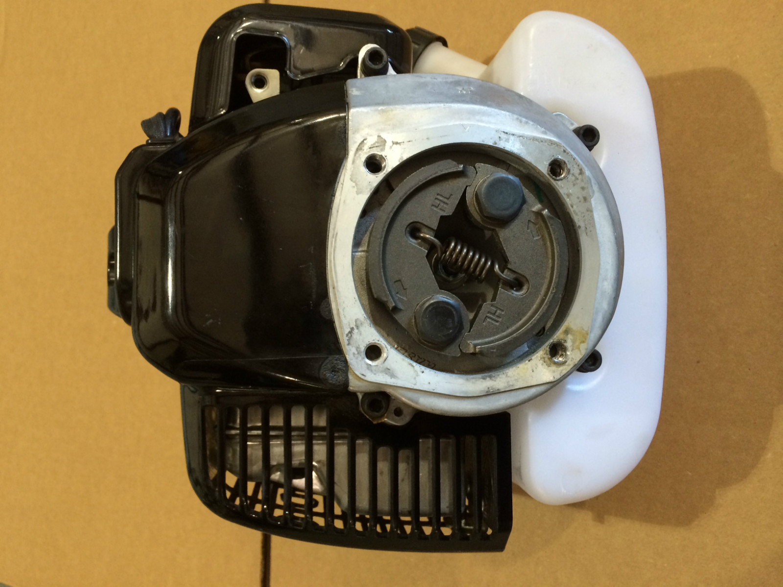

Well that's a pretty slick little engine.
Pull start and no internal reduction.
What is the spacing for the transfer case bolts?
That TC looks like a typical HS 4-stroke and maybe a 4G would bolt right on?

In my build at least this is the smoothest 2stroke I have had. http://motorbicycling.com/showthread.php?t=60263
Sweet.
If the TC mount holes are the same as a 4G a 10G would fit on there nice with factory 4G holes as it wouldn't have anything in the rear in the way, and then just use the SBP BB freewheel and standard rear derailleur or internal shifter with standard sprockets to keep the pedals.
A 5:1 4G with 9T out should even work for a direct drive.
Has the diaphragm carb given you any issues?
What is cool with them is you don't need to keep the gas tank above the carb. The issue is when it fails and even gravity feed don't work.

I have a kit with the 49cc HS 4stroke and the reduction from it fits this engine perfectly, meaning the belt versions should too.
I have had no issues with the carb. It is adjustable for mixture unlike the US Walbros, and they even sent the tool with the engine. I bought a replacement carb as backup for $10 shipped! At that price why even bother to clean/rebuild?
Yep, it's for an HS 142F-1G tapered shaft clutch attached engine, so you have lots of transfer case choices for that 2-stroke engine.
