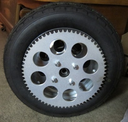

I have one of the original hub adapters from manic mechanic (Creative Engineering) which I see has been sold to another company.
http://mmbikeparts.com/sprocket_adapter.htm
I'm looking to purchase a larger sprocket for my bike (1950 Panther with 99 predator engine & Qmatic tranny) since I will soon be running it with a sidecar. I figure I will need to lower the gearing a bit to compensate. I currently am using a 64 tooth sprocket and want to go with either a 68 or even 72 (which is what I think AZBill runs on his stretch). Anybody have one or know where I can get one?

If I can avoid having to drill out a blank or enlarge the center hole I'd prefer it. But if I have to go that route then I will. I was hoping I could just order one and know it was going to fit the adapter and be perfectly concentric. If it's off it makes a big difference.

Kings really will make anything you want. Just specify the tooth count, chain type, bolt circle and # of and diameter of bolt holes, and center hole diameter and they will make it for you.

Dunno about your experiance.
I called them one day after I thought about modding out a stock sprocket, they answered the phone and I aked if they could build this.
66 tooth, 41 chain, (4) 3/8" holes om a 3.875" BC with a 1.375" center hole.
Price was the same as the site indicated, I paypaled them the bux and it arrived in about 2 weeks.
Easy.

I got a response today from the outfit that bought out the Manic Mechanic...
"Hi Silverbear,
I'm sorry, but all we have available for now is 40T & 48T sprockets.
Maybe in the future.. Check back in a couple months.
Thanks, George
mmbikeparts.com"
So, that's out. It would seem to me that someone is missing the boat and a trend lately for more four stroke engines being used on motorbike builds. We need bigger sprockets to be available with the clam shell adapters.
As I recall with the Qmatic kit for a H.S. engine it comes with a 56 tooth sprocket. I've been using a 64 and want to go bigger yet. This is frustrating.

I appreciate that you have taken the time to respond to this thread. I think that speaks well of you and your desire to serve the motor bicycling community. What I'm hoping to locate is a sprocket of the right tooth count which will bolt right onto the MM hub adapter without the need or expense of being a one off custom job. Do you have the information on file you would need for bolting to a MM hub?

Hi SB,
I think there are 2 different patterns for the MM HUb Adapter ( I believe a large bolt circle and a small bolt circle model....A customer (well potential customer) was supposed to send me the info and I was looking forward to seeing if both patterns could be put on a single sprocket (or maybe even added to our current sprockets in addition to the 9 hole mounts etc..) but I can't recall ever getting it so I don't currently have the needed specs on file.
If you can get me the needed info, we can make the sprocket for the same price as our other motorized bike sprockets.
Our prices for a "custom" sprocket are generally the same as our "normal" sprockets since we make every sprocket to order anyways (generally our prices are based on the size of the sprocket not the mounting pattern...the mounting pattern is generally the "custom" aspect of most of our "custom" orders.
About the only time we charge extra is if a person mails in a sprocket for us to measure and make (generally, the extra charge for a mail in / measure / make is $15 above the cost of the normal sprocket)...
If you give us the measurements / specs there is generally no extra charge....We can also do countersunk and stepped bolt holes (like for chain ring bolts) for no extra charge either....We can do "split" sprockets for $10 more (includes "spacer" to make the cut sprocket "round" again).
As far as time to make custom sprockets.... If we get everything we need (and don't have to measure) it is about exactly the same time to make as our "normal" sprockets.....One exception tho may be w/ really large sprockets since that requires the machine to be "reset" but typically that happens only above about 70T or so depending on what the previous sprocket made was.

Thanks for the information. I'm going to look to see if I still have a sprocket from MM with both bolt patterns. I'm reluctant to do the measuring as I don't know that I would be accurate enough. Since the whole idea is for it to be concentric and right on I would rather you did the measuring to remove any fudge factor. So I'll see if I have one. It would be a 56 tooth I believe, but from that you could enlarge it to 72 if I go that high.
