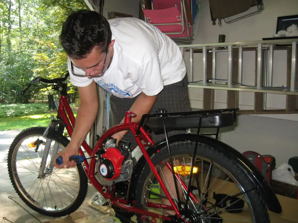

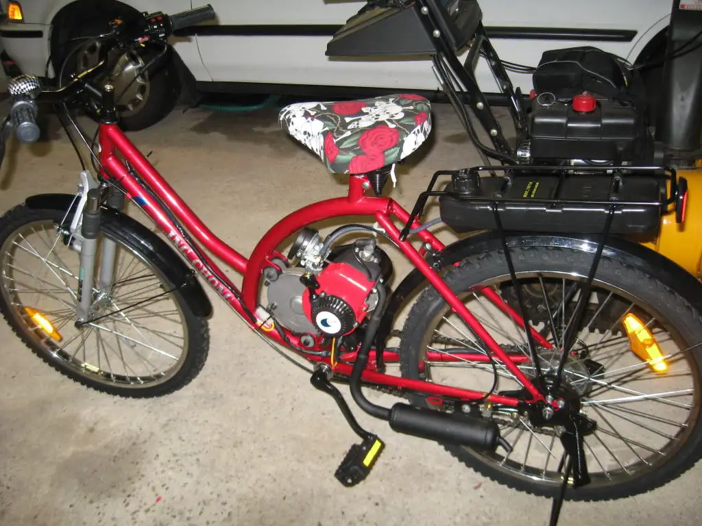

Well guys, I finally have my zipper. It was fun to build and pretty darn easy too. The only parts missing were a nut, the spacer thingy in the back of the brake lever, and the brake pads on the front were ripped. I fixed all these things and I got a new battery from radioshack. Now everything is working well. The only few stupid things I did were getting confused about which sprocket the drive chain goes on and which crank arm is right or left. I figured those things out lol. The other stupid thing is the center pull brakes. I HATE adjusting those, I will get the linear pulls eventually. I am more than satisfied with the build of this bike though! There were the proper holder loops for the throttle cable, the engine mounted like a dream on rubber cushions, and the muffler was also rubber mounted. The 24 inch wheels are steel rimmed and the spokes are size 12. The holes and hardware all lined up easily and the frame is nice and strong. The brakes are the most sensitive that I've ever had on a motorbike, the bell is cute, and the engine runs really well and revs up quickly. It is funnest thing I've ever ridden. I am so happy with this bike and the guys at Pirate, as always, were awesome and it was fun to go to the shop again. Here are some pics!

I like it alot. That is cool how it is a purpose built MB didnt know there were any out there other then the few seen on here. I like it a lot. Looks fun to ride adn simple to build and work on.
