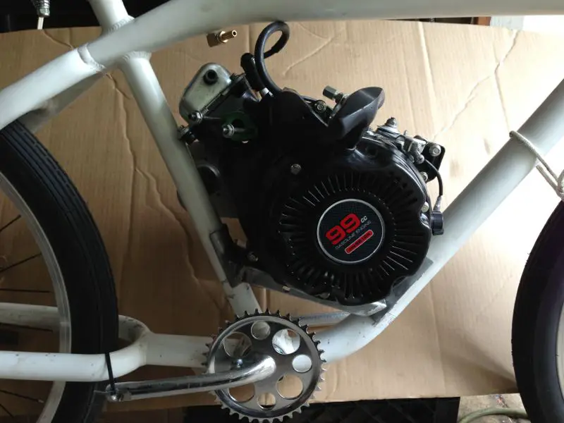

Here's a engine mount that I made for my newest race bike... It's for a aluminum Felt cruiser with a 99cc Predator engine.

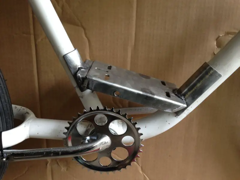

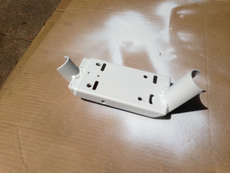

I use a engine mount from a 49cc 4-stroke kit & welded two 1/2 pipes on each end to protect the frame from damage.
This mount is easy to make & rock solid! (^)

I am surprised that the kit mount fits the Predator. I was given two mount plates for my 98cc cruiser, a kit mount and an agk Predator mount, and the ki mount bolt pattern did not line up with the 98cc's bolt pattern, whereas the Predator mount did.

How about welding a flange on each side of the half tubing and use U-bolts to bolt to the downtube and seat tube. Use PlastDip to protect the frame and increase holding strength. Or instead of U-bolts, use another half of tubing with a flange on each side and bolt both flanges together.
