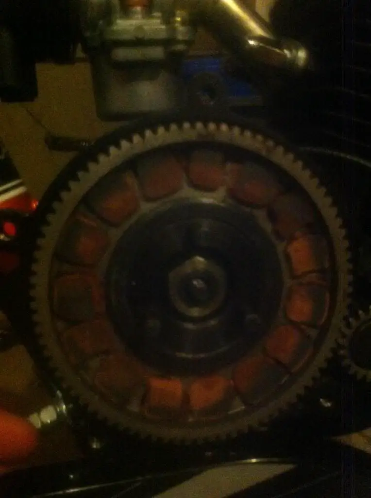

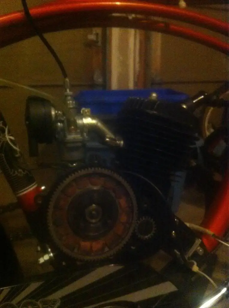

Hi Everyone,
I want to make this as to the point as possible for a hopeful quick fix!!!
I have a motorized bicycle a friend asked to repair. The problem is the bike won't start because the clutch slips.
I took off the head at first to see if the piston was seized, but when the head was taken of the clutch caught on and the piston moved with ease. I ruled that out.
But when the head was placed back on the clutch would catch on for the piston to move around 1.5 times then the clutch being slipping. Take note, I tried using a flat head screwdriver on the small gear (behind the clutch cover) and the piston would not move even then while I turned the gear, I have a feeling something is jammed...
Lastly, the large gear is loose when the plate is taken off. I have multiple engines in my garage and not one of them has a loose large gear.
Would appreciate any help/tips on how to go bout solving this.
Attached a few pics too.
Note: Please assume I have a poor knowledge of the terminology.
Thanks in advance,
Vinoy

pics are hard to see. but it looks like you got the red clutch pads & they look like they've spread a bit - sometimes when this happens, the pads won't grab both plates - take each pad out & file or otherwise trim it a bit so it goes all the way thru the slot to press on the back plate

The clutch has a little wiggle in it, this is normal.
Before ya start taking stuff apart try this. Take the small screw out of the clutch plate, Pull the clutch lever in to make adjustment easier, Then screw in the flower nut a couple or three notches. This is only a simple clutch adjustment problem, But you should check out the rest of the site anyway. I'm SURE there's a post or two on adjusting a clutch.
The only time you need to take out the pads is if you are replacing them or, sometimes, if you burn the pads a little you can bring them back with a little sandpapering. Even if they do spread a little the large internal clutch spring will push them in place, no problem.

I don't believe your piston/crankshaft is seized. I think your only problem is a clutch that needs adjusting. You need to understand how the clutch works BEFORE you take it apart or at least read some of the good information here so you'll understand what you're doing and why.
Here's one of the best posts available which will guide you step by step through the proper procedures for adjusting the clutch. http://motorbicycling.com/showthread.php?t=22729
I'm a little concerned that you removed the cylinder head. Did you replace and/or inspect the head gasket? Did you torque the head fasteners down after you replaced the head? These points are critical.
If I understand correctly you can't rotate the crankshaft with the cylinder head installed but it does turn with the head off. Was a new spark plug installed? If so you need to compare the 'reach' or length to make sure the piston isn't contacting the plug. Compare the old plug with the new one if that's the case.

Try removing all of the red clutch pads, and file the edges down a little so they fit into the clutch gear better (looser). See if that cures all the problems.

2door is right about everything, Listen to him. The only thing I might ad is that you can simply take out the new plug and THEN see if the piston moves. This WILL NOT tell you anything about the clutch adjustment, only about plug lenght and if you have the right size spark plug or not.
And again, You rarely need to take ALL the pads out, trim them, then replace them. Doing this won't hurt anything, Just a lot of wasted time. ANYONE thats EVER had one of these apart knows that there's a HUGE internal clutch spring. A little bit of pad spread is not going to keep the pads from seating. Worse case, The spring will force the edges off the pad and you wind up with some pad dust in your case. You can then just blow this out.
The engine should have quite a bit of compression, so trying to turn it with a screwdriver may or may not work. So FIRST, Adjust the clutch, put the old plug back in, (the one YOU KNOW was the right size,) Then try starting it. If the piston STILL wont move and the clutch isn't slipping, then check for piston seisure.

Excpecially 2door for his reply, because of your suggestions I was able to fix the issue very quickly. The issue was that the piston had been hitting some part of the head preventing the engine from turning over.
To solve this, I placed another head gasket to provide a teeny bit of clearance between the piston and the head. To my surprise the clutch caught on and I was riding in a few minutes.

I have a theory. The original owner might have installed the cylinder without a base gasket. That will lower the cylinder/head by few thousands of an inch. If the head gasket was used several times it might be compressed enough to allow contact between the piston and the head. Just a theory but installing two head gaskets would raise the head enough for clearance. I'd keep an eye on it however and retorque the head after the engine has reached operating temperature a couple of times. 120 to 140 inch pounds will suffice.
