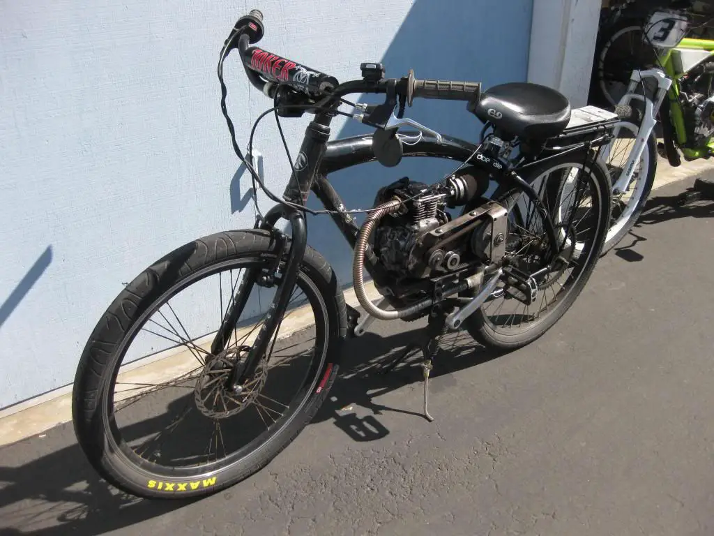

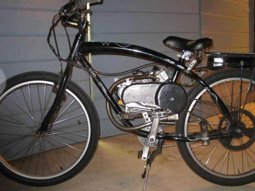

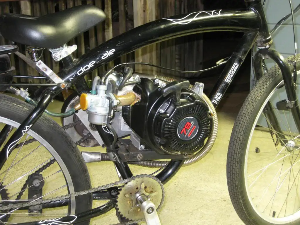

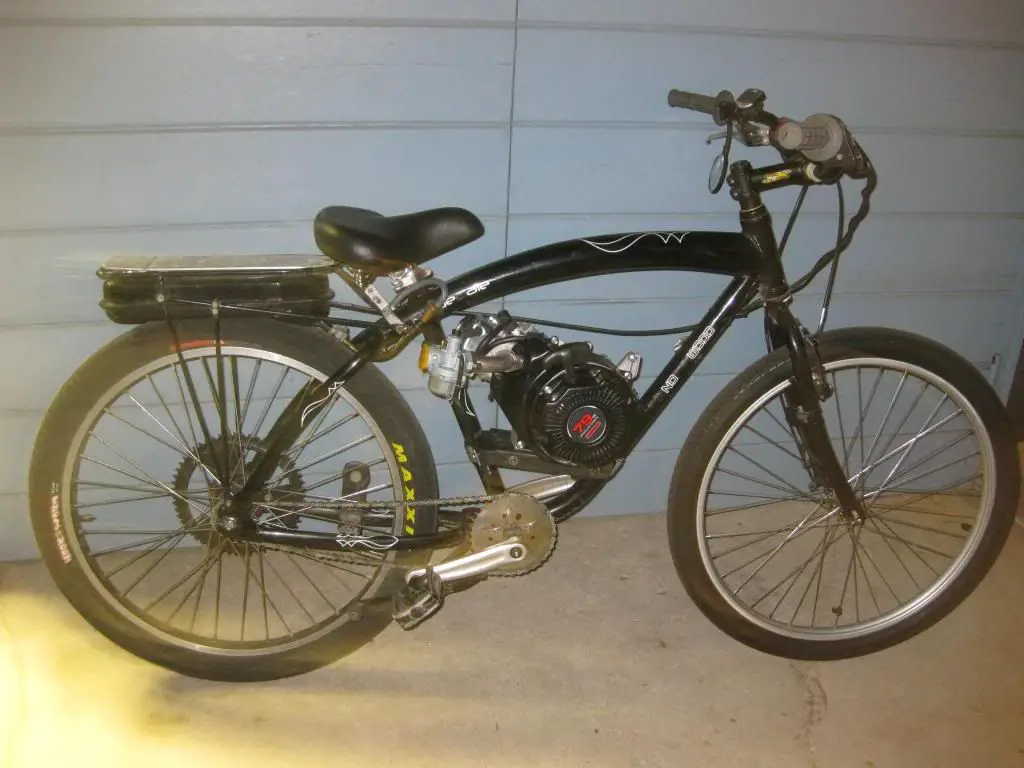

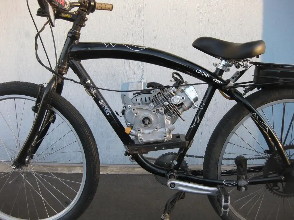

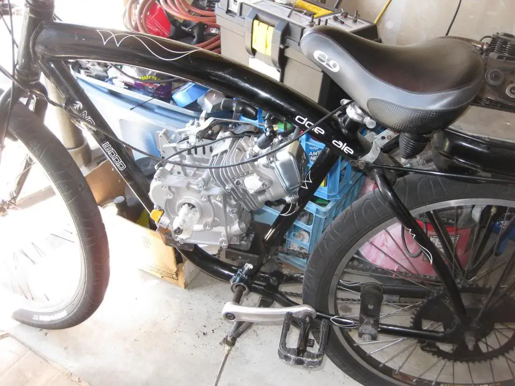

This is one of my first 4-stroke builds and the engine has 20,000+ miles on it and still runs strong. The only reason for the new engine transplant is that I'm re-building it for one of my sons and he is bigger and has hill's to tackle where he lives. Here's some pics.....
And yeah I know Aleman......but sometimes bigger is what's required cuz not everyone is a peddalin' fool.

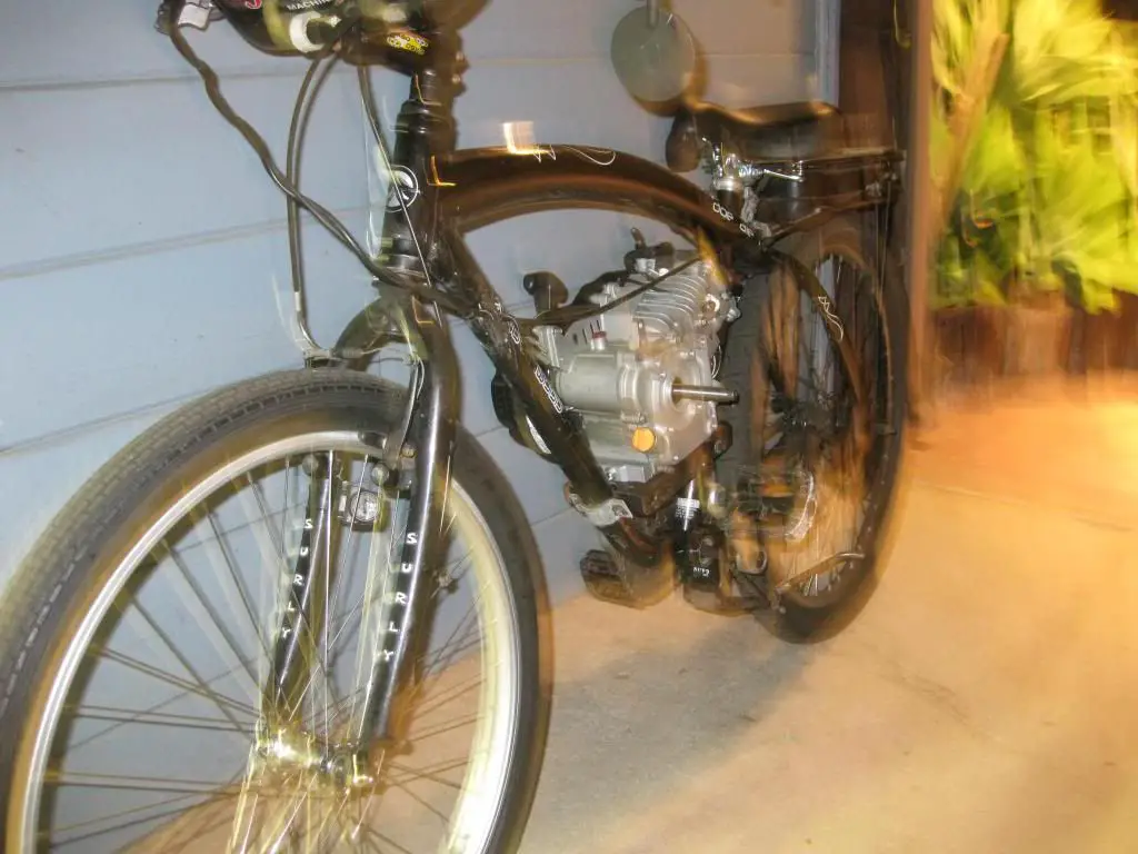

will the 99 cc HF fit upright in that frame?
Just asking, i know it's an easier and cheaper install to do it on the kit mounting plate.
Is your son going to race it on the track? Father - son racing team?
Yes the 99cc will fit upright in that frame, but i'm going to mount it slanted.
I doubt my son Neil will be racing it, but ya never know! Yes I have a son named Neil, but he's much cooler than you or I laff

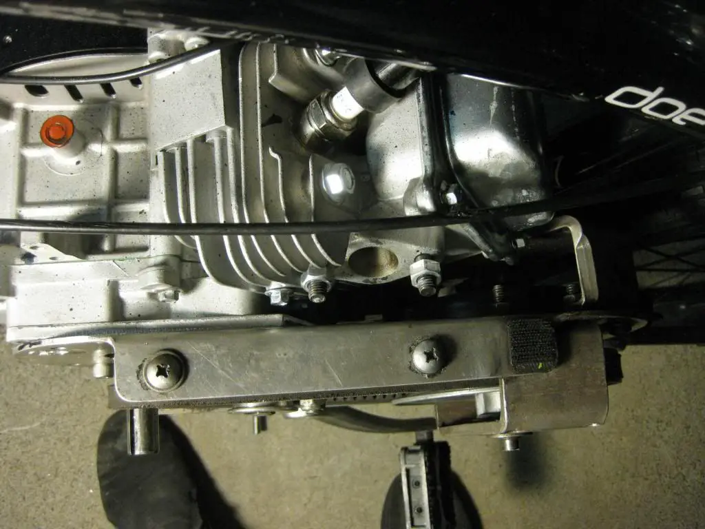

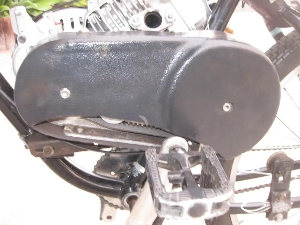

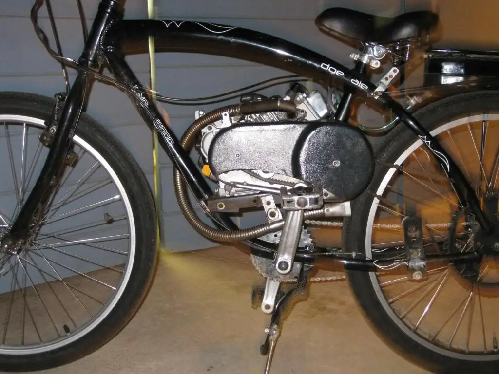

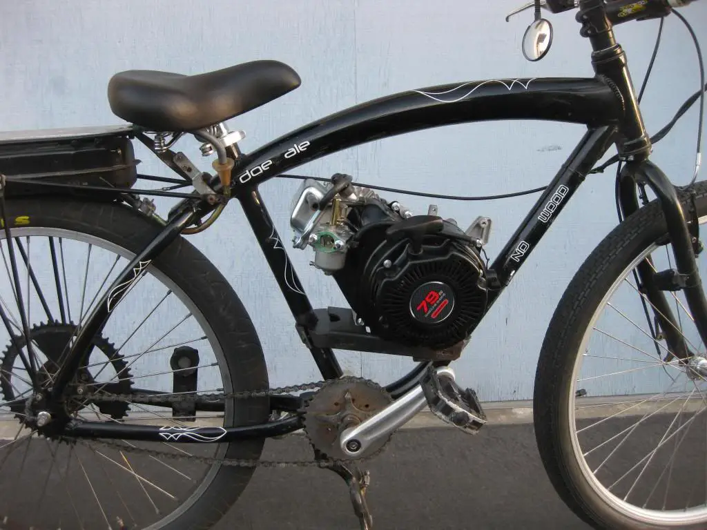

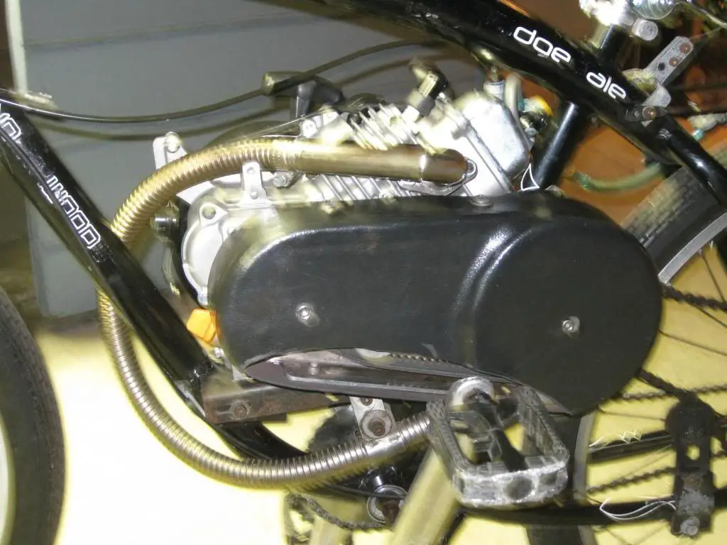

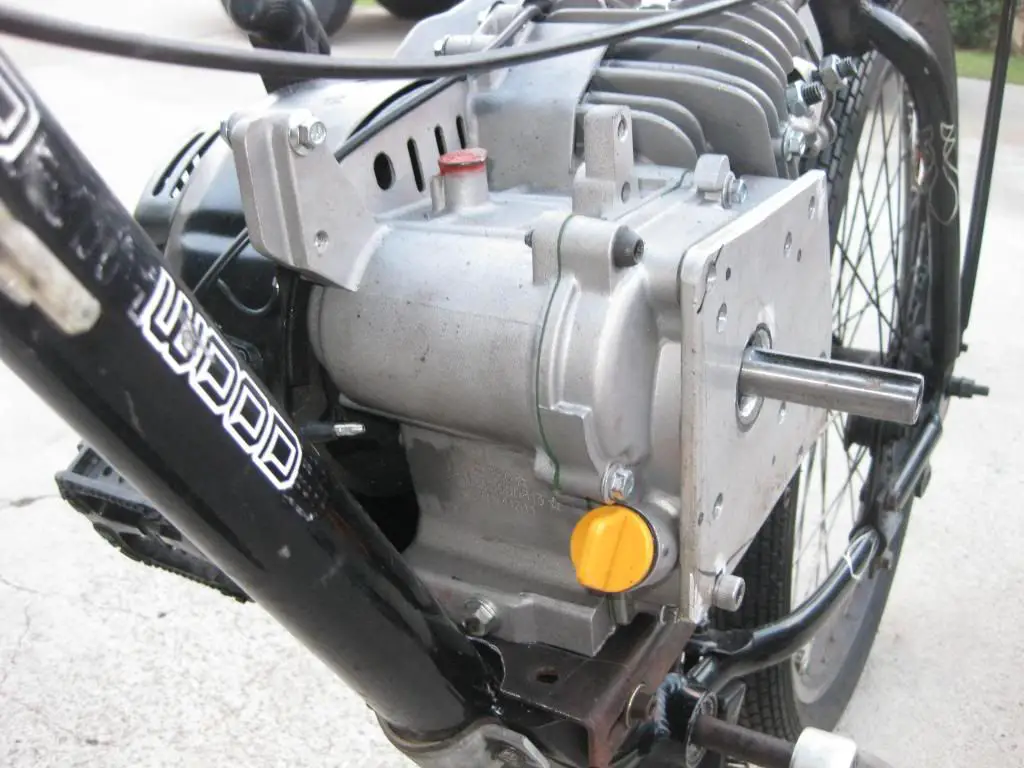

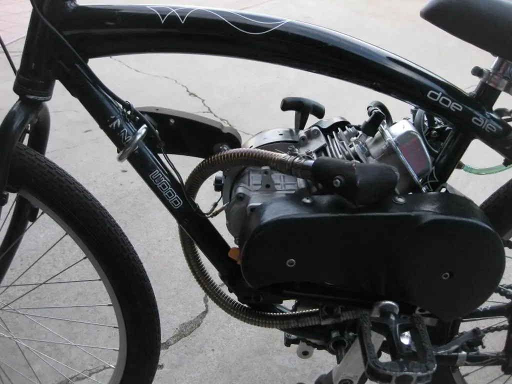

This set-up is still using the stock 170mm alloy cranks and the wide sealed cartridge bearing bottom bracket from Sick Bike Parts and they do clear the 11" wide 79cc HF Predator engine with EZM tranny.
This build is nearly complete.....once again .

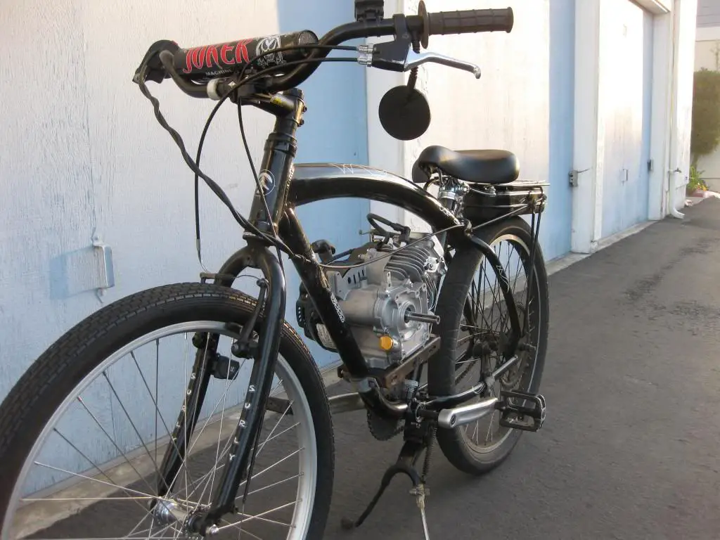

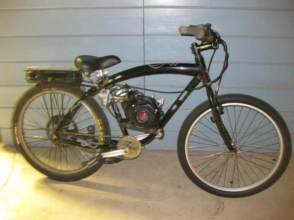

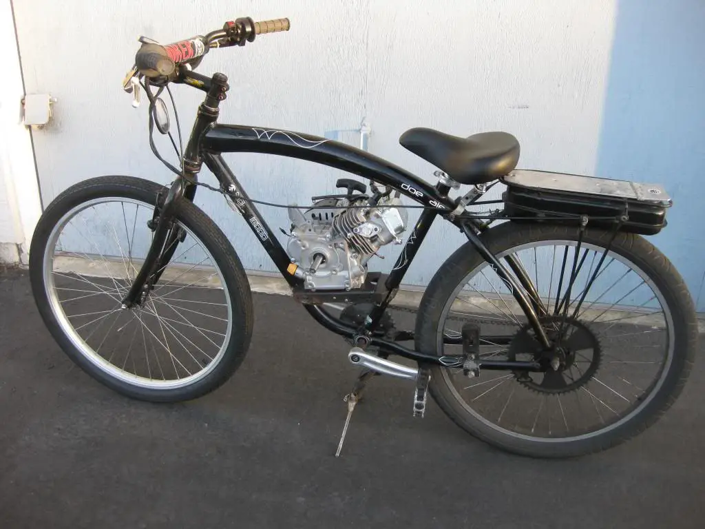

That is looking really nice scotto!

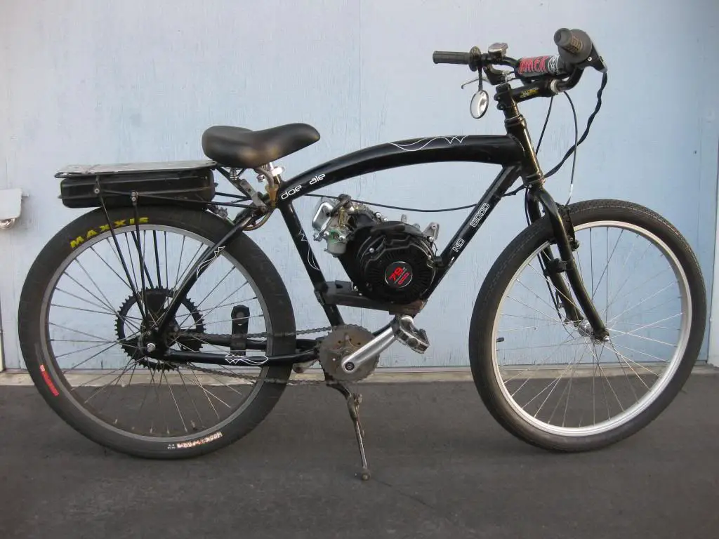

Thanks Dan, was able to take it for a test ride yesterday and it cruises nicely! Still have to install an air filter, proper throttle cable, rear brake and a front engine mount. Then it's the little things like a proper sparkplug, dialing in the carb, routing and securing the cables and stuff like that.
Hope my son likes his new/old Christmas present ;)

It's the 19mm carb that AGK sells.......a chinese mikuni type knock-off.
Workin' on the rear brake and waitin' on a throttle cable......

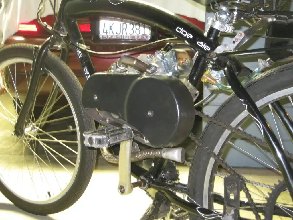

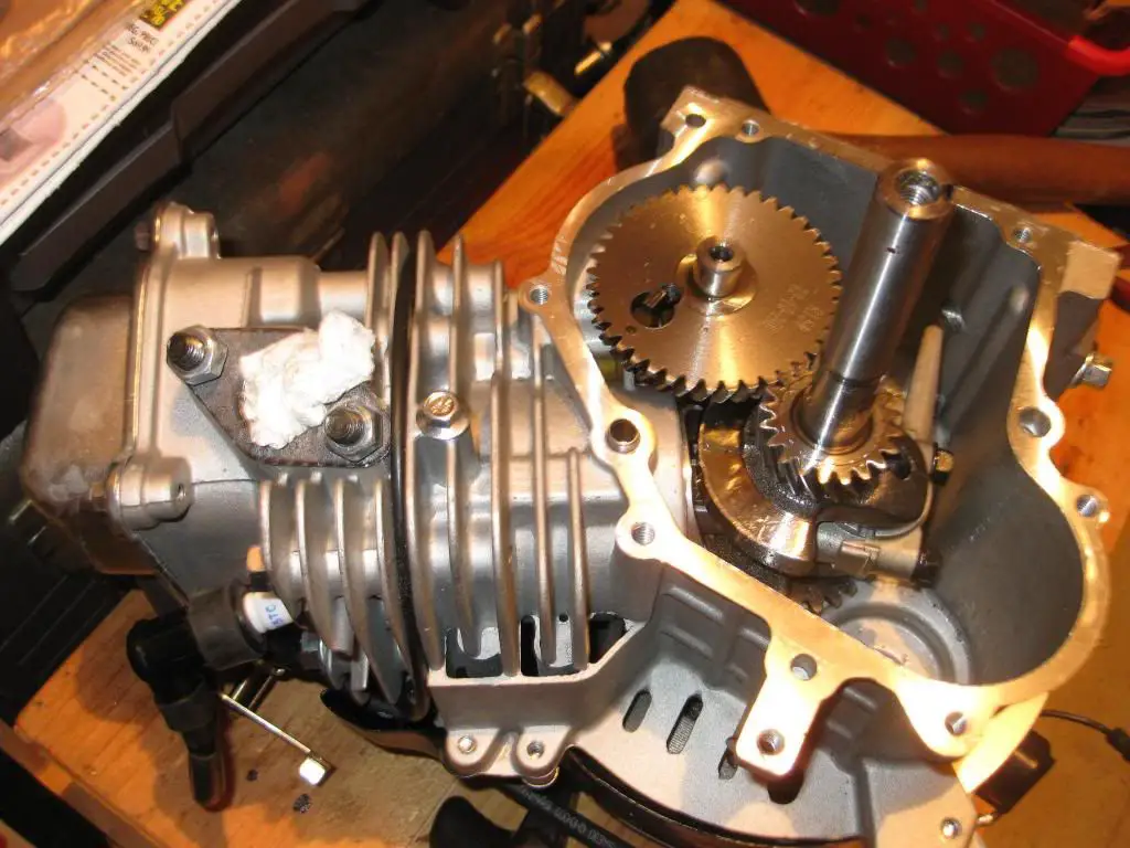

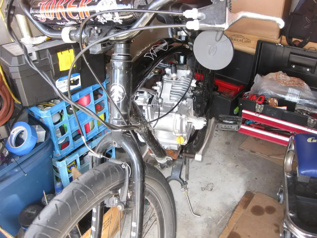

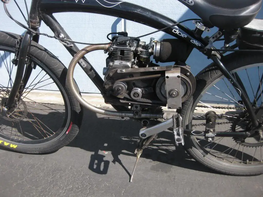

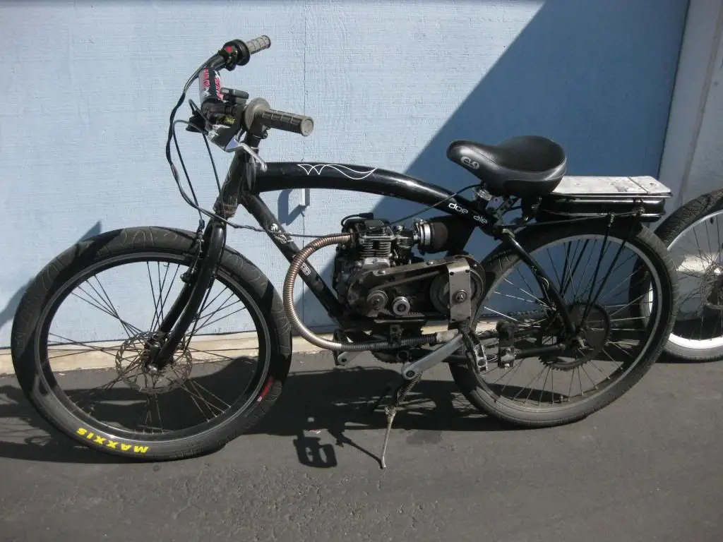

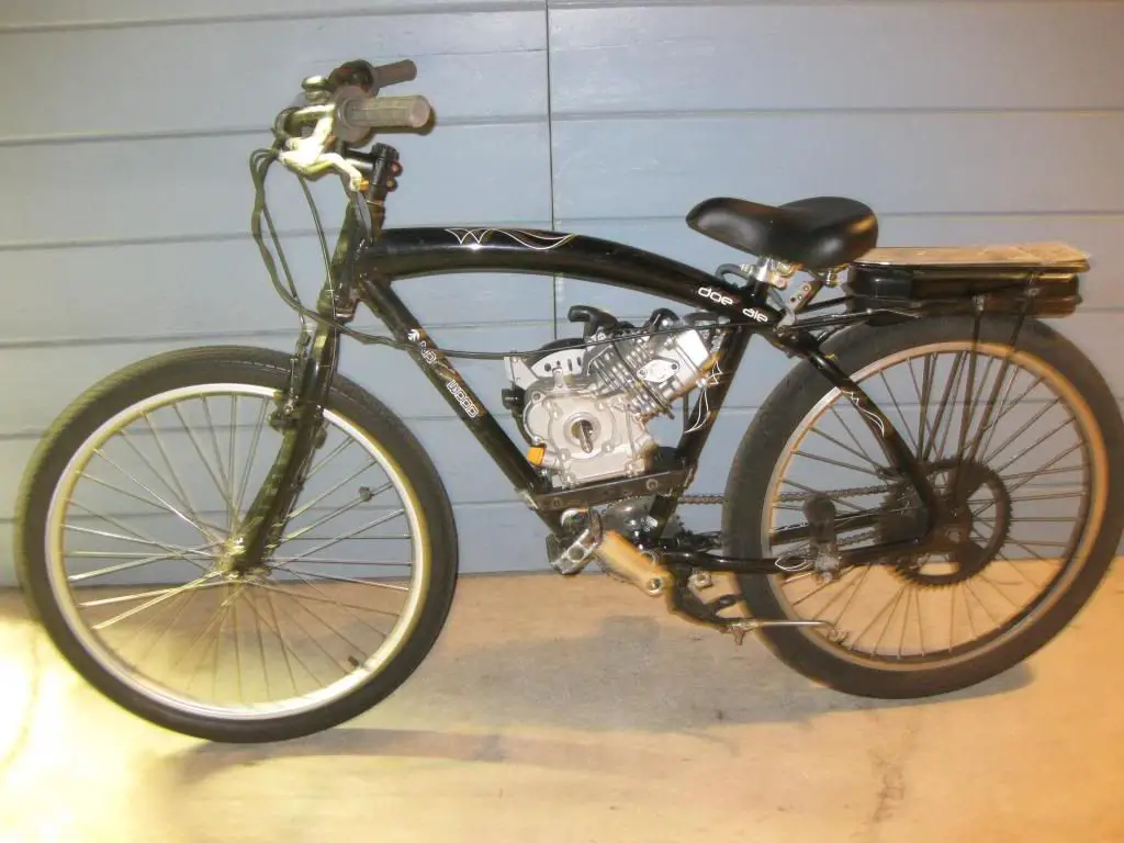

Just an update while waiting for a couple more parts.......a little pictorial so too speak.....
....and there you have it, that wasn't too bad I hope?

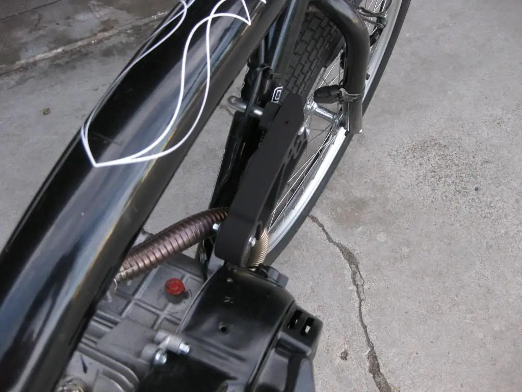

scotto

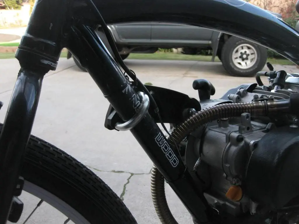

acknowledge your cleaver use of the cast piece to make your forward engine mount --bravo!!
I hope others note and follow your example
