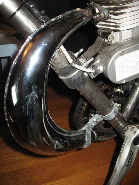

I will return the kit or sell it as used kit (I'm in Los Angeles). Here are some pictures from the broken expansion chamber.

Don't give up yet!!! The first problem that I can see in your pic is the rubber between the engine & frame... That can cause the engine to vibrate more & cause things to break.
If you can bring the bike to me, I'll hook it up for you. (for a case of beer.) ;)

Listen to venice, and don't give up... its clear that the problems you are having are all related to excessive vibration... due to the mounting system you used , fix that and your zoom engine will be fine and highly reliable... i have about 2000 miles on mine now and no problems, solid mounted the engine and made sure everything was properly aligned.... David

I followed your recommendations and saw Norman/Venice Motor Bikes a few weeks ago. Did the modifications with him and now the bike is pretty reliable. Didn't had a single breakdown since I met him. It even runs faster now.
Thanks again!!! xct2
