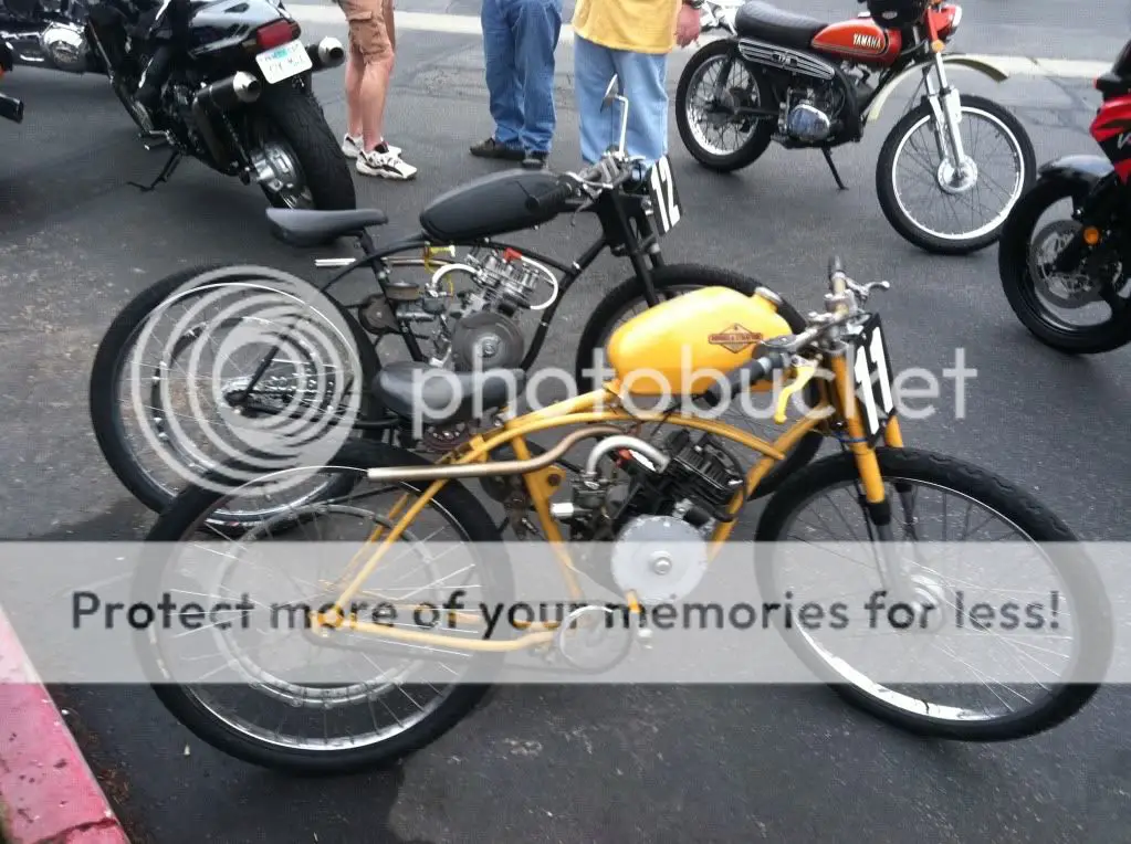

Here's the way I always level my carbs.
I've used this setup a dozen times with no problems. Mine are all four strokes though. I used a curve from some old drop handlebars with a flange welded to each end. I looks like your angle is not as radical as mine, so you could use a very short tube. .
