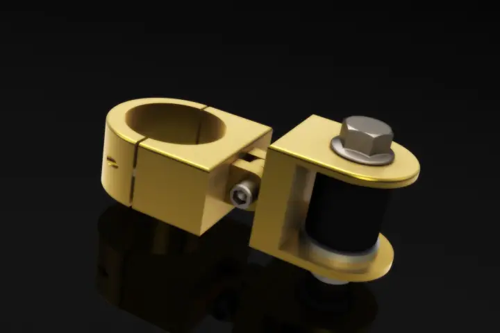

Why don't you add a swivel to it? (to better attach to different cruiser frames.) I gave that design to Manic Mechanic, (& never even got so much as a thank you from him.) I'll give you a better one! ;)
PM me! (seriously)

Looks familiar:
Yea we originally got the idea of using a bushing from yours and the riddley. But unfortunately from what i understand you do not make these for production, and the riddley is only for felts. The manic mechanic mount mostly unavailable as well. As you can see, besides the bushing, ours is completely different any of the available mounts. You guys should be thankful for people offering custom-made parts with this level of quality in mind.

Now if that flat plate was running w/the frame and there was a flat plate sticking out the bottom of the bushing then it would adjust too many frame angles,,,and a flat plate w/a hole in each end added to the kit would allow for a lot more frame confogurations

And if one of these was used on the rear also so the carb could be leveled instead of doing the best w/the down tube angle we can and hoping it will be ok,,,and clamp on would work especially w/the half pipe pieces placed under them

Hmm a swivel, that is a good idea!.
Throw up a pic, or drawing, our model is very easily changed

don't have a scaner, but if you observe the flat plate on 2door's beige bike and rotate that 90 degrees,and make the "center lines" the "side of the plates"on this and the spools (this centers the spool on the frame)(and adding a third piece,the flat bar w/holes in the ends ,allows for height adjustment)clamping w/pieces of half pipe as for alum.tubes is best for steel too

plate on the frame ,and another on the end of the spool, and a -1/2 to 5/8 bolt through the hole

Thats a nice drawing,
That would make a good front and rear mount for angle adjustment of the motor (leveling the carb.) the wide clamp will protect the frame tubes from the glass cutter effect of a muffler clamp bolt effect,,my concern would be the small piviot brakets strength in the pic.as there is some amount of twist torque to the motor from starting and just plain miss assembly and rough riding (and though sounding like a broken record ,a short flat bar between the piviots on the front mount would allow a lot more variation in engine location and different frames)
I would guess the spool part would be a standard size and the clamps might be different sizes ,"or a larger one" w/spacers for different tube sizes

swivel action!
There is no reason why this shouldn't work. My question is what is the material? If aluminum then the area of the swivel could be a concern. There is not a lot of material there to take the stress and vibration that can be produced by these little 2 strokers. If aluminum then it needs to be a very high allow. 6061-T6 or better and the sharp corners radiused. Also I would ask what hardness is the bushing. I'm a strong advocate of solid mounting the engine or if a resilient material is used it needs to be as firm as possible. No rubber or easily compressable material. I'm impressed with the design. Good work and good luck. Keep us informed of the progress and testing.

swivel action!
Just a suggestion...buy several bikes that have different frame configurations...then make some mounts. That's what I did...and it's a REAL eye opener.
I have over 20 common bike frames, that I modeled, precisely, in 3D...I also accurately modeled in 3D the complete engine...problems still come up! It is not easy to create a universal part.

The welded clamp in post #4 has a wide top footprint on the frame and only a round u bolt on the bottom,I'm thinking a wide footprint on the bottom also

for the front and rear mount, extend the "inside" of both mount parts (spool and clamp) a little longer ,round it and drill all the way through ,then a flat bar w/end holes on both sides w/heavier bolts at the piviot points,,the flat bars would be short ,just enough to allow pivioting ( longer for front mount extream reaches )
