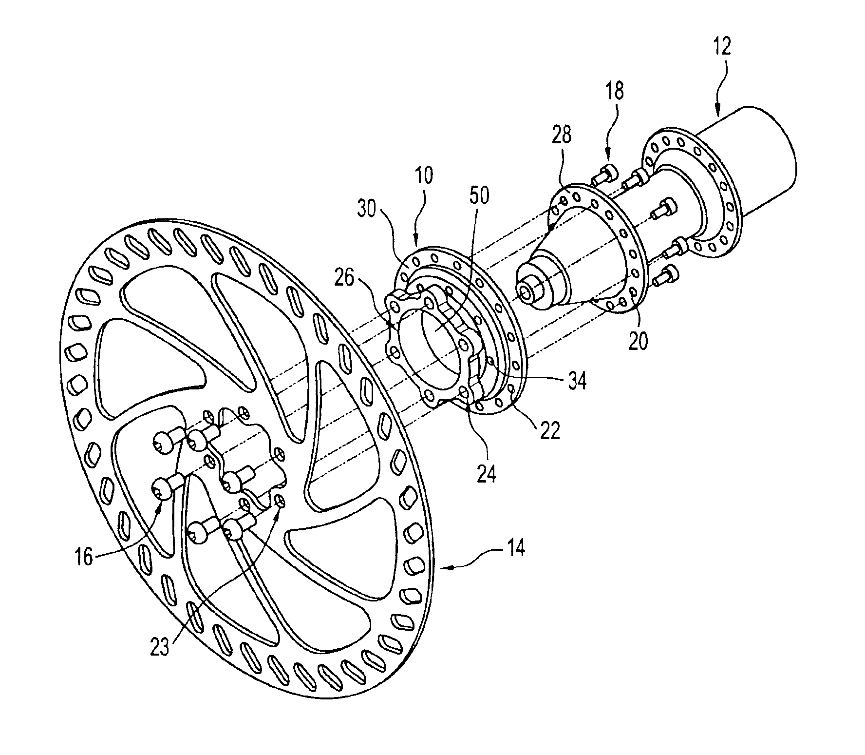

Hello,
starting to collect my puzzle pieces for my build. I've bought a 48 hole Surly front hub and would like front disc brakes, but no one makes a 48 hole front hub for disc brakes. I want the strength because I am big and my bike will be heavy and built for long distance traveling. I will using the motor to help with pedaling and need fast and sturdy wheels. I would like at least one disc brake on the bike.
Has anyone seen a clam shell adapter for disc rotor mounting for the front hub? All I've found were for sprockets.
I have a Staton 48 hole for the rear and haven't found a left hand threaded disc adapter that will work with the Top Hat adapter. Most are right hand thread. I've only been able to find a chinese scooter rotor adapter that isn't ISO standard, so it won't work with the Top Hat adapter.
I might have an disc hub adapter machined or go with the Halo Spin Doctor disc 48 hole rear hub, so I could use the Top Hat adapter, but then I'll have to figure out how to mount the discs on the rear.

Aside from the fact a 48h wheel is overkill, I'd be most concerned with trying to use an adapter because THAT will be the weakest link. That will fail long before you twist the spokes off a proper stainless-spoked 36h wheel or even a 32h wheel. Sell the hub to a BMX'er and get a proper 36h disc hub.

The adapter is bolted on from the back, through old spoke holes on the hub. Then the wheel is laced using the adapter as the other flange.
