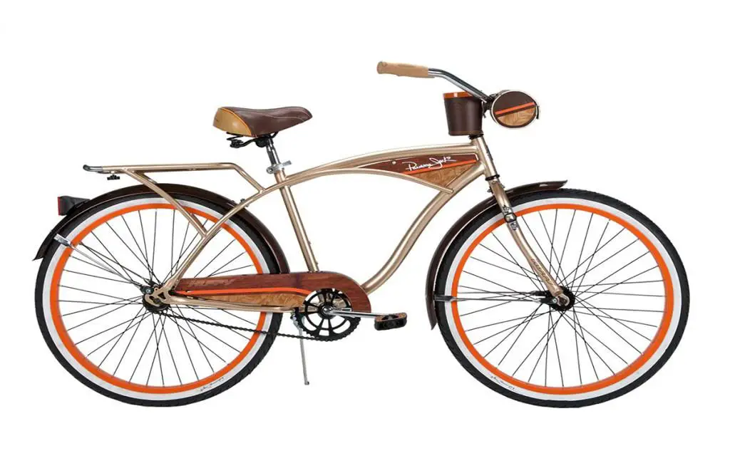

I'm going to be starting my second build soon and plan to buy one of the 66cc Flying Horse Engine Kits from Bikeberry.com.
So I'm looking at two different bikes right now and finding it hard to decide which one to go with.
So if you guys had to choose, which one would you go with?
First choice - Fito Modena.
Cost - $169.99 plus $39.99 for shipping.
Second choice - Huffy Panama Jack
Cost - $129 Free shipping to store (Walmart)

I think the second one would be a easier to build. I think gas tank would mount easier...Just a suggestion.

Yeah I'm sorta leaning towards the Panama Jack as well. The mounting of the gas tank worries me with the first bike and the price point of the Panama Jack is nice which allows me to buy some better parts for my build.

The Jack's steel frame will make it easier to mount the kit. I dislike aluminum frames myself due to the difficulty of getting the tensioner totally solid mounted. With a steel frame, a tack weld takes a few seconds and is bulletproof.

I'd go with the Fito Modena. It looks like a better made bike. The Huffy Panama Jack is an extremely low end bicycle that's known to have a weakness where the rack is welded to the seat stay. The frame likes to break at that point.

Huffy's are heavy and weak, thus true mtn. bikers invented the "Huffy Toss" a game of mostly strength that was the hit of many mtn. bike race events. Who ever could toss the Huffy bike the furthest won the Huffy Toss and a decent prize as well. I miss those days.

The huffy would most likely be the easyest build but I like the FITO better it looks like you could turn the top tube into the tank for that clean look.
Me, too. Huffy's have earned themselves a pretty bad reputation for the low quality frames. Especially considering the vibrations through the frame from a China girl motor, I'd go with something else entirely. Keep looking around, but if it is one or the other of the two, take the other.

BTW, looking at the bikebuyers site, you can get the same Fito frame in steel, if you prefer (I do).
You can also get the Micargi Rover in alloy or steel for the same price. I think there are quite a few builds here using the Rover frame...

My latest build is a steel framed Rover. It easily gobbled up my 79cc engine. Lots of room, and easy to work with.
