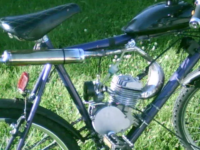

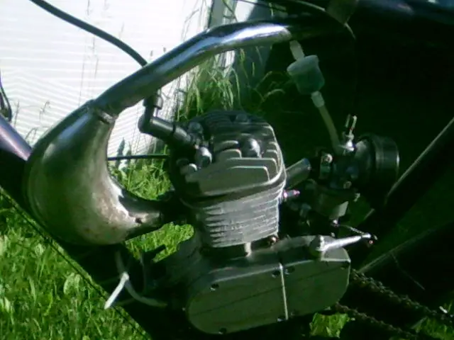

rider131
Jul 30, 2010
6
Canada
if you wanna make it simple do like me take the expansion chamber of a 49cc dirtbike/pocketbike, install it upside down and weld the original muffler on and there you have it.
PICT0021.JPG xct2
