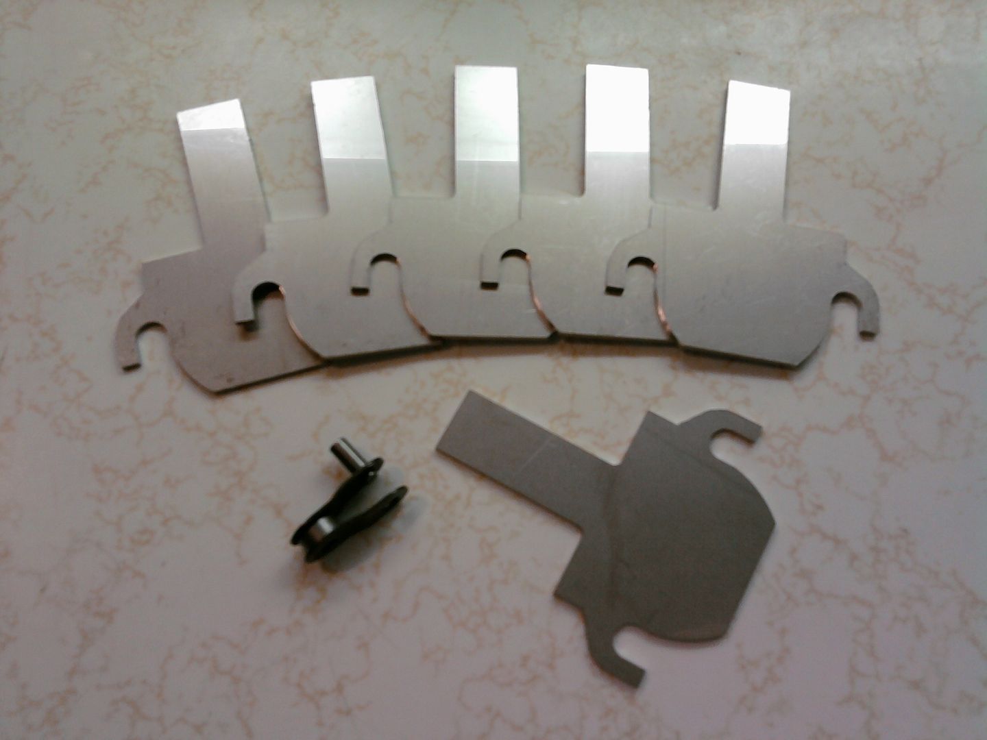

Here's the shims that I use between the rear engine mount & the engine case... You can easily make your own.
