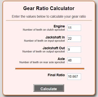

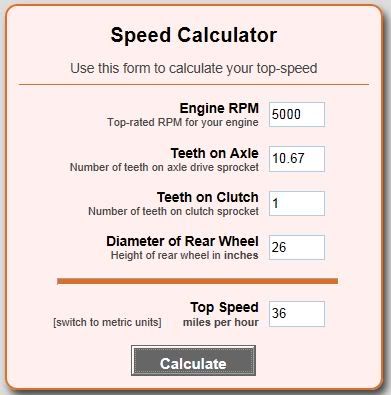

With the JS at 11/22, would output 9/48 be okay for my purposes? This gives me 29 mph at 4k rpm. Governor removed of course. Is this an okay engine speed? Max at 6k indicates 43.5 (I don't plan on going that fast!). Will it pull hills, or is that too high a ratio at 10.67?

Where I live hills are everywhere, so most of my builds are built around hill climbing. The Preddy has pretty good power. Even so I would feel more comfortable with a ratio in the 12s. The 97cc Lifans I have been running are very happy and actually smoother at 4400rpm at cruise than they are around the upper 3Ks. Have not tach the Preddy but it also is smooth turned up a bit. Seems I would rather turn em a little more at cruise and have the ability to climb most any hill with out assist.

I am going to weld it on. And if 4400 is good as for cruzin, then 27.3 mph is just okeydokey. My main issue was just with the overreving, seeing as how 3600 is max rated... lol

I just built one, The mounting plate that comes with the Pred99 is the same way I went, Install your chain, orient the motor with the plate bolted onto the engine, get your chain tension correct or close, tac weld 4 corners, roll the bile around, ensure chain is running true. I don't know about the spider adapter, I use a sportscarpat adapter for my CB110, fantastic product, and if you loosen one of the allen bolts holding it together, you can tap it in or out to align chain. My total reduction is 13.2:1, but I have a 29" rear wheel(9" more rollout that a 26" wheel) the hill climbing is fantastic and the cruise is nice, my guess a 56T on the rear would work, that motor is a torque monster!!

I have one on a belt/fricton drive 2 speed build with a 9.75:1 ratio in high. It climbs steep hills in high gear as long as I hit them with moderate speed to have the engine in it's power band.

I have very high hopes for it's hill climbing capabilities because Wayne was able to climb steep hills (with a little starting speed) on a 9.75:1 ratio, and I will be using a 10.667:1 ratio.
