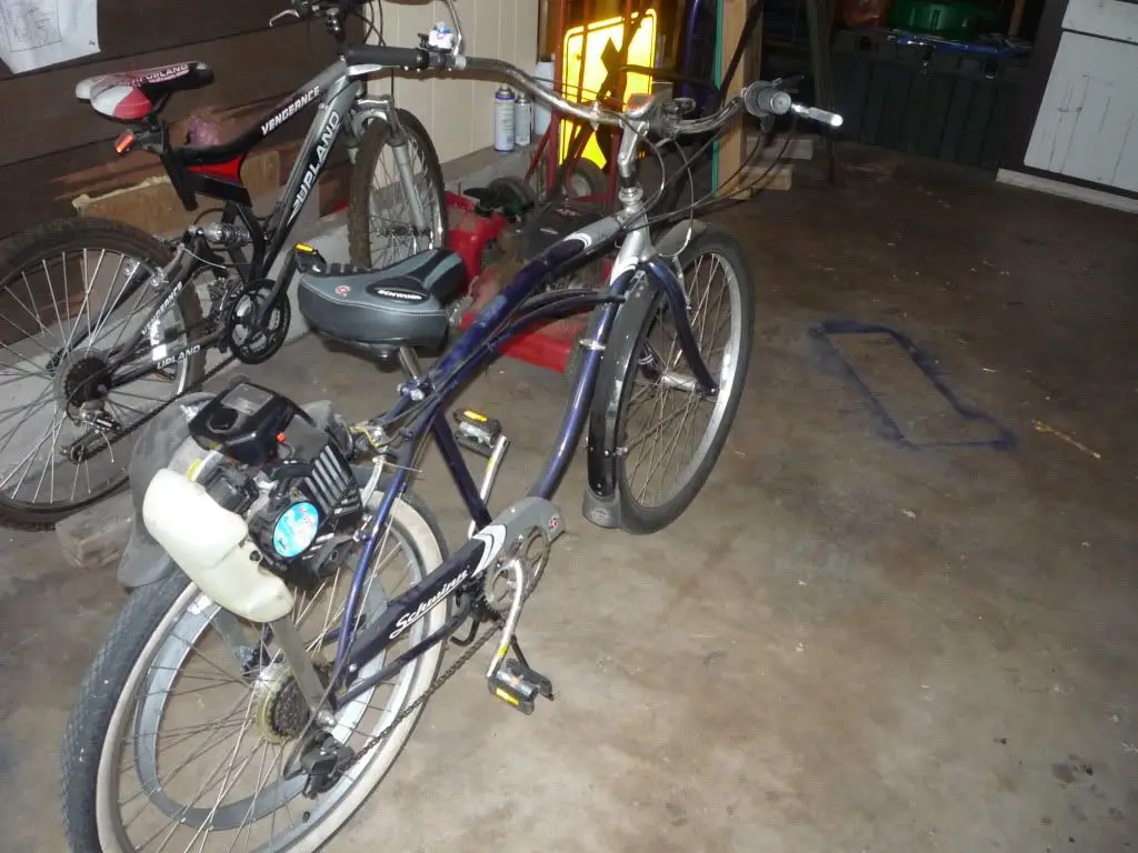

my new bike gebe from a co worker 100 bones for bike and kit deal
all the left overs for the 4 stroke kits my engine just blew up one day when i started it right now im on my gebe kit that i got love it but realy did enjoy my 4 stroke while it lasted it wasnt as powerfull as a the 2 but until it blew up worked out quite nice i rember the hills with it i wasnt to impressed i had a 48 tooth i used for awhile with good results the 4 stroke i get will only be for fun just wish i new when dax was gona get some in
