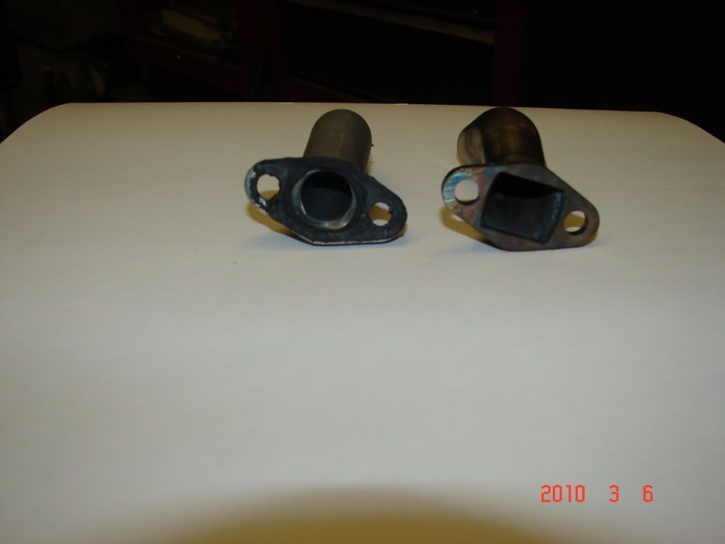

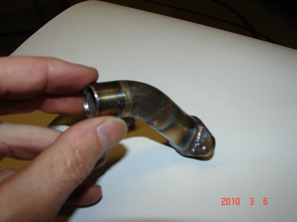

Tired of grinding out the stock intake manifolds for better flow and port matching? I have been building these custom port matched intakes for the two strokes. Here is a shot of the manifold before I hit it with the scotch brite pad. Ported stock aluminum on the left, custom one on the right. I made a CAD drawing of the old flange perimeter and then carefully measured and drew up the cylinder port. Laser cut a bunch of cylinder matched stainless flanges. I then made a small die to press the round tube to the rectangle shape of the cylinder port so the flow path smoothly contours into the cylinder. Tig welded together. These manifolds really open up the two strokes. Seems to make the engine run smoother, also.

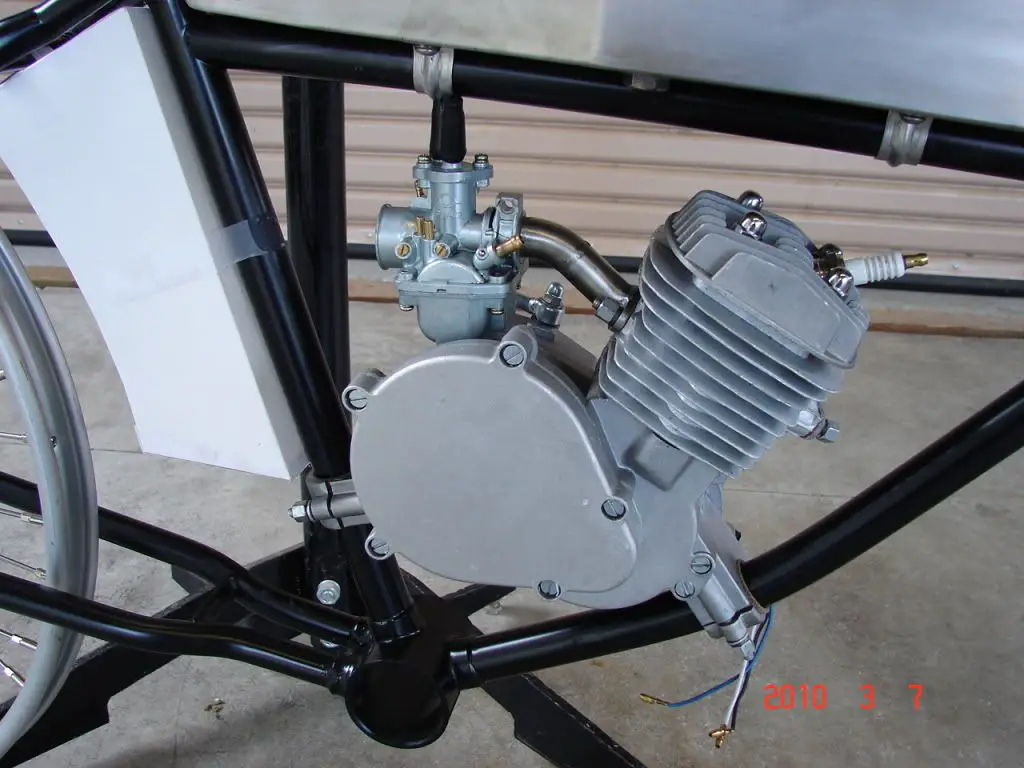

Here is a picture of one cleaned up and mounted to a Grubee GT5 slant head engine.
Does the square ported ones on the right can be use to a non ported stock engine (factory specs)?. I want to order one though
BarelyAWake
Jul 21, 2009
7,194
21
Maine
Even a unmodified intake port is larger than the opening in the stock intake manifold's flange, provided you remember to trim the gasket to fit - it should still have some benefit ;)
