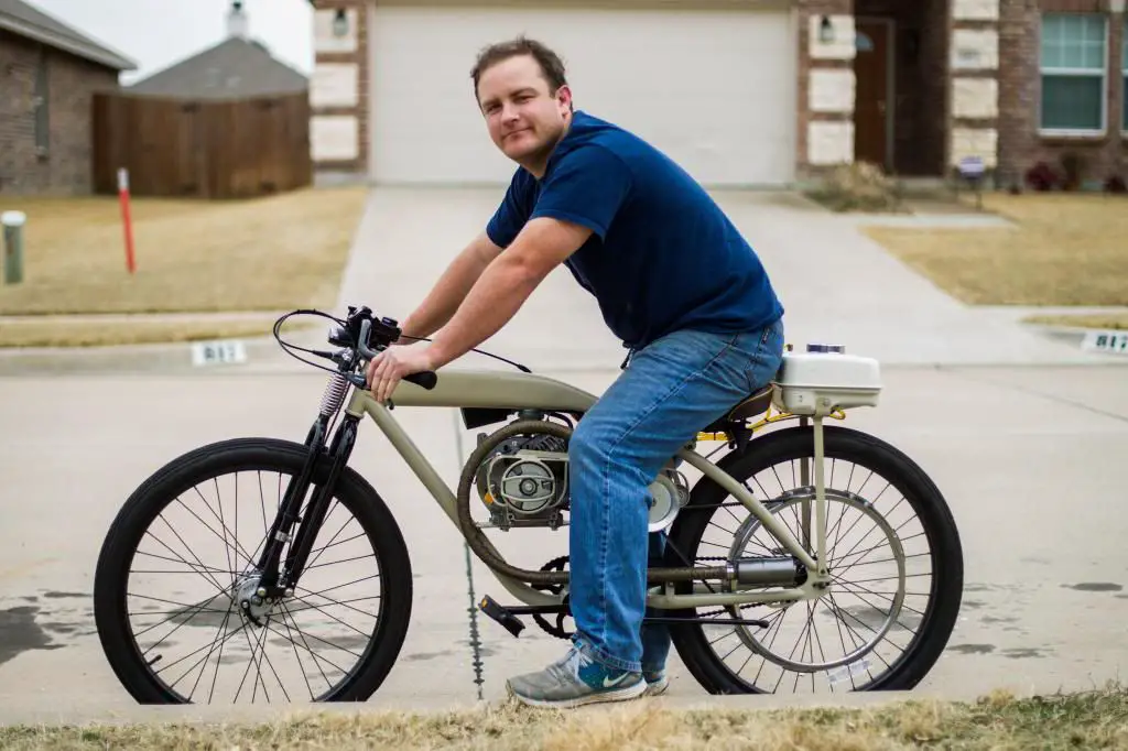

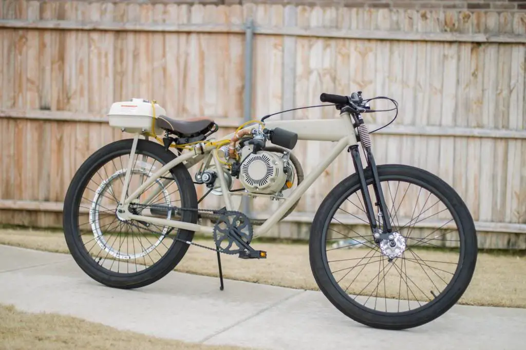

Bike is basically done. I need to add a tach, speedo, new hand grips but otherwise I've put around 10 miles on it so far and it works great. My 10 year old and 13 year olds have both driven it and can't get enough of it, the wife says I should hurry and build another so she can have this one.

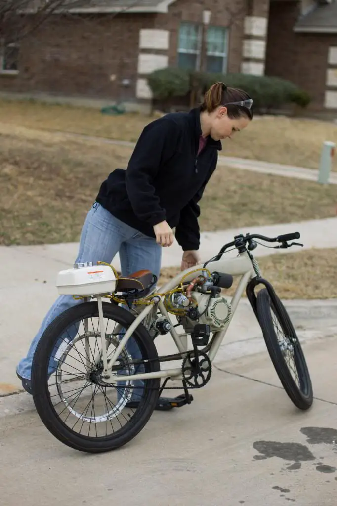

She is 5'10" so you can get an idea of how tall the bike is, it sits pretty low.

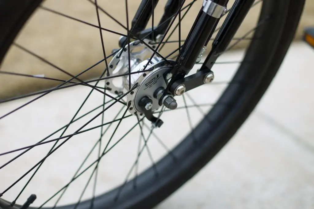

I deciced to keep the front brake polished and think it turned out pretty good with the other chrome accents on the bike.

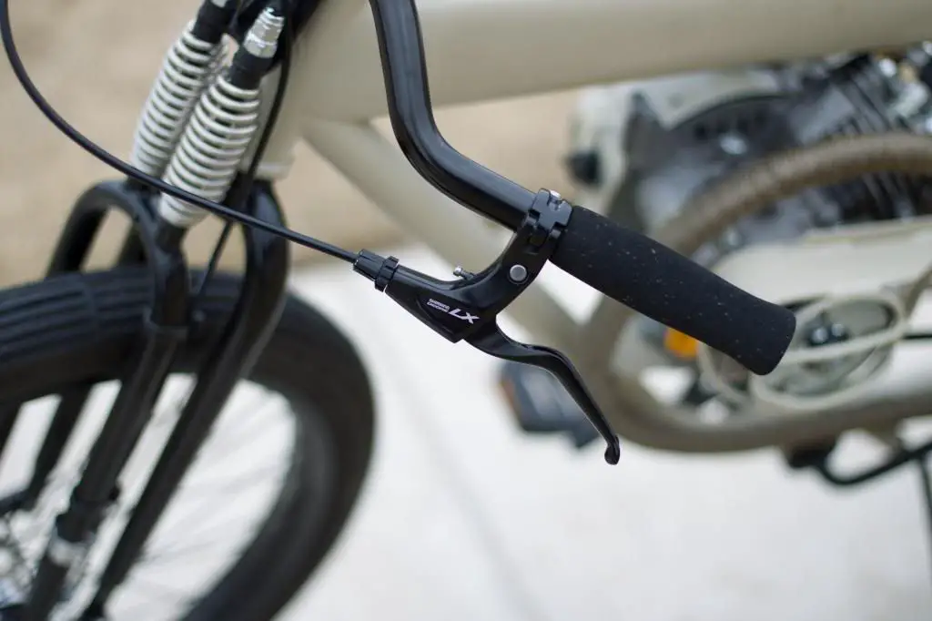

This bike was originally a coaster brake only bike so I added some shimano X7 brake levers which work great. I'm not sure how they're considered in the biking community but from what I can tell they're excellent, the spring loaded feature is nice.

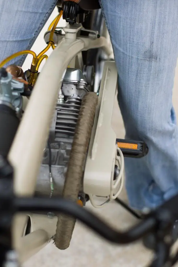

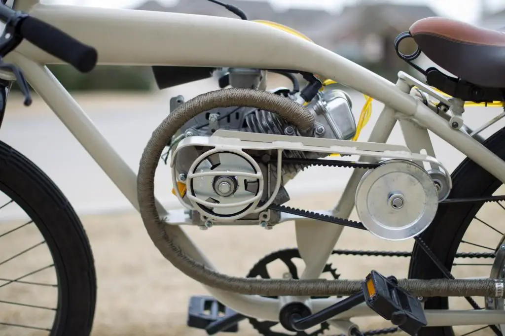

Closeup of the new clutch and pulley guard I made last night out of 2" X 1/8" steel plate and 1/4" round bar.

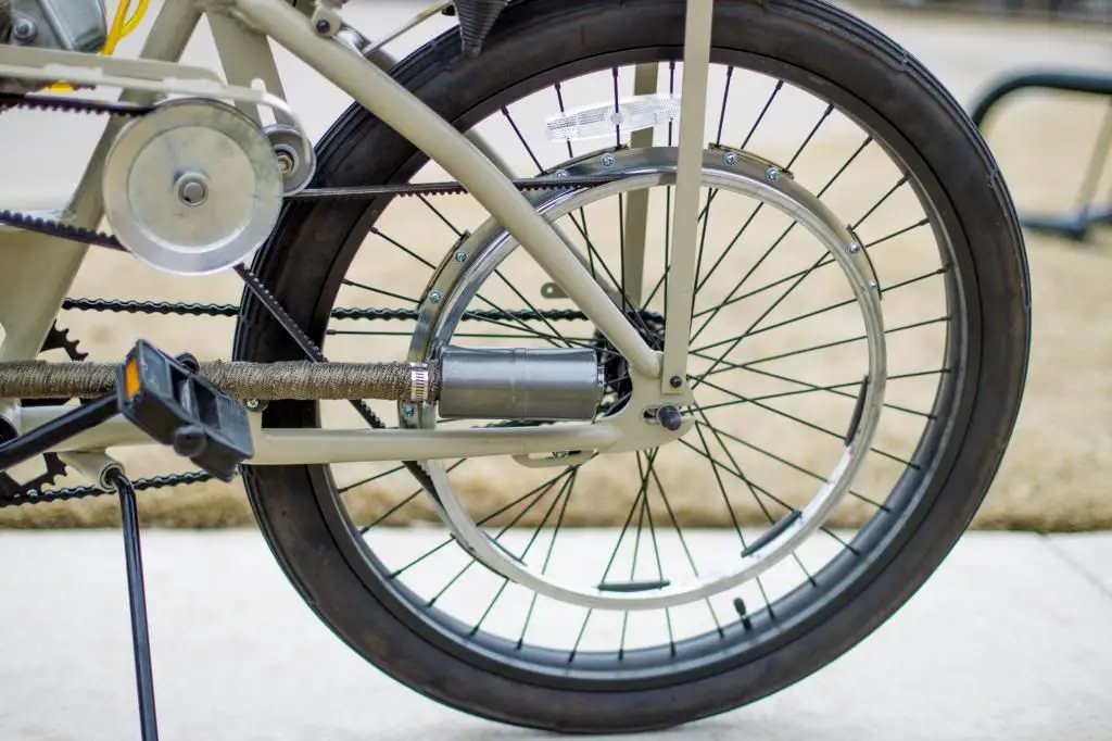

Rear sheave. I discovered due to the wide tires I needed spacers for the sheave. I wasn't willing to wait another week or 2 to get the already made ones so I took some 3/16" plate I had and made my own.

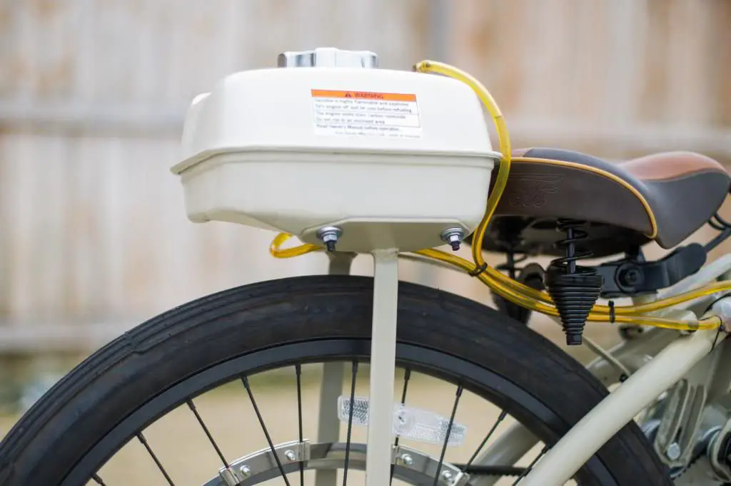

Honda GX390 fuel tank purchased new so I didn't have to worry about rust or other dirt, the supports are 3/16" X 3/4" flat stock and the mounting plates are 1/8". I ran a 1/2" X 1/8" strap to under the seat post area to keep it in place, this mount is very sturdy yet light for being made of steel.

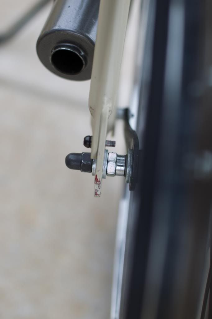

Good shot of the washers I added to the rear axle so I could have the needed clearance for the belt and sheave, without these the whizzer sheave was hitting the frame due to the needed spacers I had to install on it to clear the belt/ tire contact.

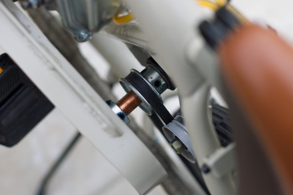

I wanted to add a spacer between the 2 pulleys on the jackshaft till I add in the constant tension pulley later on for more ratio options on the fly. For now I picked up this copper spacer from home depot that fits the 5/8" shaft perfectly.

Sounds real tame, not much of a growl to her. Everything looks great, but I think it needs a different gas tank as it just doesn't look right. Though it is your bike and you had your reason for doing it that way.
All in all great build...

The mount plate I made from 3/16" steel. I drilled out multiple holes per engine mounting hole and used a die grinder to elongate them so I wound up with 4 slotted holes so I could adjust motor position and tension the belt.
The jackshaft uses a wheel hub for a shifter cart with 5/8" ID bearings and 5/8" shaft.
Pulleys are
3" on clutch that goes to
5" on jackshaft
2" inner jackshaft that goes to
15" Whizzer pulley
