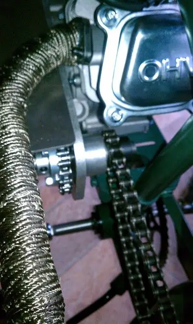

Ok I have a bit of a problem here. I'm using a 79cc predator, agk jackshaft for said motor, agk sprocket for attachment to 6 bolt disc brake hub and in this configuration the output sprocket is WAY out of alignment. In fact if I were to center the motor in the bike the chain wouldn't even clear the tire. So I need to move the output sprocket away from center but if I move it as far out as I can (using a .250 spacer so the chain doesn't rub) I would still have to run the motor off center by quite a bit. Is this normal or is the hub (what im pointing to in picture) supposed to smaller? I don't see how this can be a correct setup cause as is the only way for the chain to clear the tire and correct alignment with the sprockets is to move the motor off center by approximately an inch. Any input would be greatly appreciated cause at this point I'm stopping till I find a solution or result to building my own jackshaft which I DO NOT want to do. And I already tried contacting agk. There emails down so if anyone knows whats up share the info cause I don't want to give up and I'm already invested but I'm not going to build a bike with a motor so far off center and I'm not going to invest in machining time.
