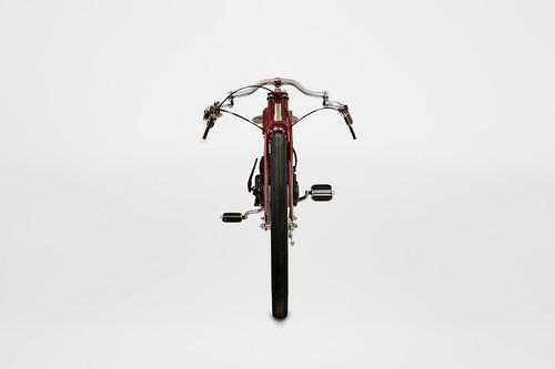

Here is a one piece crank bent by hand. Well, by hand using a torch and a nice big cheater piece of pipe and a bench mounted vice. 9 1/2" I.D. Bending cranks and getting them straight is a pain. Some come out better than others.
