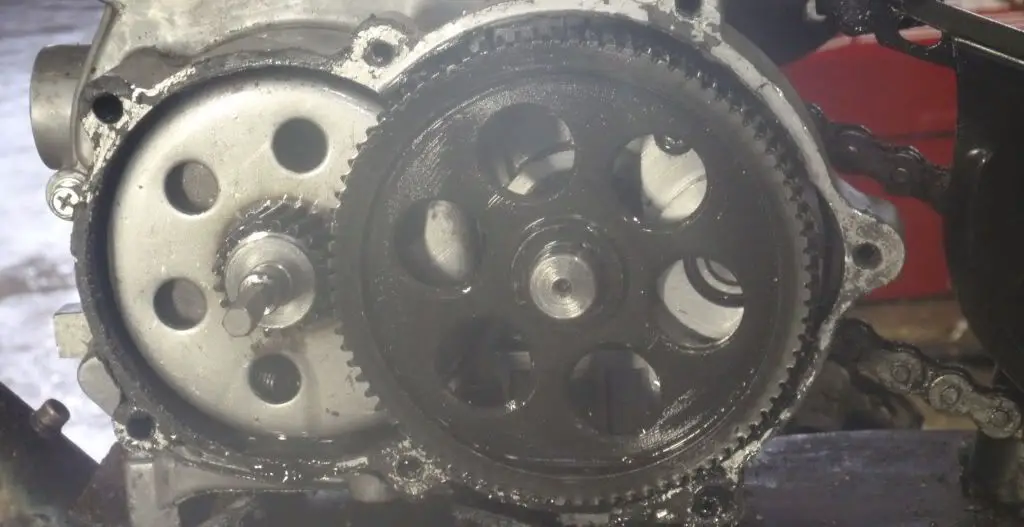

Looks like my 3:1 gearbox - NOT A BELT DRIVE!
The good news is that your drive sprocket is fixed . The freewheel version self destructs rapidly...
Is yours a chain drive?
Does anybody here have a genuine 5G HOOT gearbox like I do? From pictures from old, it looks like the same POS to me. Looks like they threw the trash out there again hoping some sucker like me would get stuck with it. Bikeberry was very clever in avoiding showing a picture of it. They also delete the negative reviews on this kit.
That being said, I do enjoy trying to make this gizmo work better. Most everything just flops around in there, including the clutch gear because of the uneven weld protusions in back of the bell and then slop in the bushing, with only the large gear trying to hold it all in place.

I made an interesting discovery on my HOOT gearbox today concerning the noise. I ran some valve grinding compound in there not caring if I destroyed the thing or not. That didn't seem to improve anything. On a whim, I then loosened the screws on the cover maybe an 1/8 inch or more. That did the trick. I would say more than 80% of the noise vanished and what was left was much softer. That is as far as I got with it today. I just wonder if it could be in that back sprocket that is behind of the big sprocket. It has to be an alignment issue there because the front cover only affects the shaft that those two gears ride on. Maybe I can get away with just a thick gasket if that large gear is riding the clutch gear okay.
Thought I would update because the Chicoms are still trying to peddle these things.
