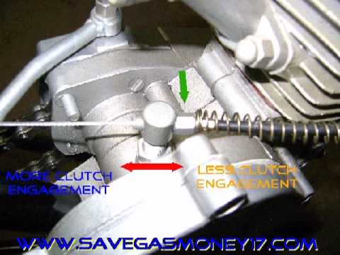

I packed red grease into the clutch actuator and between the bucking bar and bearing. It's a lot quieter now that it;s got some miles on it too. Should I pack grease into the clutch too? Like unscrew that bolt and pack it in?

it's sealed at both ends, so shouldn't need it - I doubt it would hurt anything tho

Yeah, A little grease on the big clutch gear and the small bevel gear. Just a few dabs, It will spread itself around. And don't get any on the pads for obvious reasons. It's a metal to metal gear, OF COURSE it needs a little grease. And I always pull out the bucking bar, shove grease in the hole and push the bar back in. Then I pull out the clutch lever and grease it up too. Anything thats metal to metal needs grease.
fatdaddy.
And OH YEAH, If ya get ambitious, pull the clutch plate and you'll see the tiny bearings in the clutch itself. TRY to get a little grease in there too. Sometimes I just drop a little heavy oil,(50-60wt.) into it. Again, it's metal to metal, Needs lube. Just a drop or three, too much will spin it back on the pads. oil+pads=BAD.

If you pack this area, grease can work it's way past the bearings enough to contaminate the clutch pads. I saw this problem here in a clutch thread somewhere...

I always fill the transmission shaft area with grease. Even if it does get past the bearing it won't get on the clutch pads.

Yeah I'm pretty sure the noise is coming from the "transmission" shaft. I meant to get a big plastic syringe and pump it in but I figured I'd ask first. It's really thick so I don't think it would become runny. Also I cracked my head in half today (the motor's, not my own) so I put on the old one and it runs the the same.

what you probably saw was a reinstall of one that had been out - these usually don't need grease unless you take them out, then put them back in

It was next to the blinker fluid .how the **** do you crack a head in half ?????? terminology it is a clutch shaft not a transmission shaft . it only requires a little bit of Greece just to keep it wet .it doesn't need to swim in the ocean just because you live next to it !!!!!

Granted, the post mentioned he had been filling it for a long time before it got messy.
I think a little would be good but don't fill it full.
